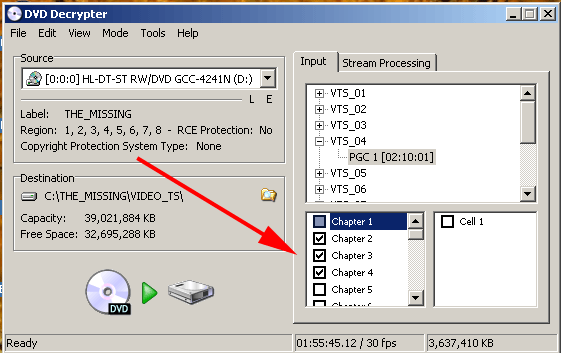

  6. Member adam's Avatar
    Sep 2000
    Open your DVD with DVD Decryptor. Hit Mode/IFO. It should select your main movie in most cases. In the box that lists your chapters simply uncheck the ones you don't want. For instance, in this sample pic, DVD Decryptor will only rip chapters 2 through 4. You can see what each chapter contains by simply playing it in a software or hardware dvd player.

    ComputerNerd. Open DVD Decryptor. Click on the mode option. Select IFO.

    I'm pretty sure that all versions of DVD Decryptor have the IFO option. In any case, go to the homepage and make sure you are using the latest version.
    Let me get this straight though. You click on the mode option and in the drop down box all that is listed is ISO? There should be three options, FILE, IFO, and the ISO which has a submenu for read and write. I can't understand how these could not be visible.
    The shortcut for IFO mode is I. Try hitting it on the keyboard and see if that takes you there.

  14. Adam,
    It turns out that I had an older version of DVD Decryptor. I've downloaded and installed the latest one.
    Yes, your instructions are correct: select Mode; Select IFO; follow the blinking lights, and the chapter selection comes up. I wish there were a way to de-select all and then re-select only the few that are wanted.

    Right click anywhere in the chapter box. Choose select none.
