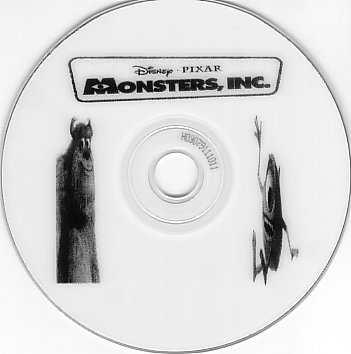

Here's one of my first labels using the CW-50:
