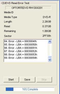

Well, here is the scan of the discs that I got. I stopped it at 16% since there were too many errors. I think I am going to be returning these discs pretty soon.
PS: 8 out of 10 discs look like this
Actually, my LiteOn drive is brand new, so I have no idea what the firmware is. I'll definitely do the other test after a while.
But, the discs to seem bad, don't they? -

All we know now is you cannot read them perfectly in that drive at that time. This can mean many things.
More testing needed.Want my help? Ask here! (not via PM!)

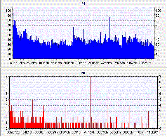

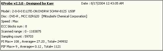

Here is the result from Kprobe2 on the LiteOn burner. This test was done with a different disc, im the same batch.

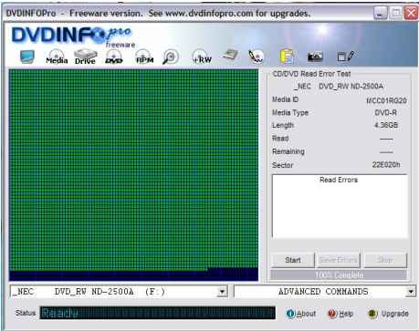

Hey aanaravs, I just burned a DVD at 4x...name a couple apps to run tests on it with and i'll post the results? Using an NEC-2500a 1.07
Run the speed test from DVDInfo Pro and scan the disc surface using Nero CD/DVD speed. Thanks for the help.
Okay...burned a full disc at 4x. Then confirmed data. Here is the read test from DVDInfo.
Seems to be pretty good stuff to me. Will re-run a test tomorrow...as of now, letting ink from an epson r200 dry on it.

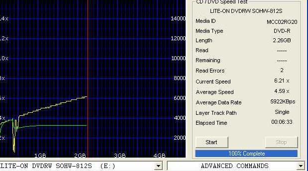

This is another test that I did. Same image file, different disc from the same batch and burnt @ 4x. The previous one was burnt at 8x.
aanaravs:
Thanks again. That looks like a really good scan, assuming there is a fairly even graph. I should have mine by Friday; hopefully they will burn as well as yours. I'll have to see which burner thay prefer. This should be better than the S03s. Hopefully they don't raise prices. I especially like the low PIFs.Still a few bugs in the system...
