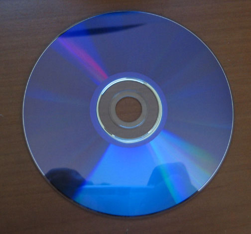

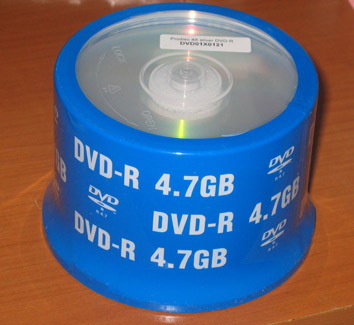

  17. I bought "Prodisc Pioneer certified 4x DVD-R Matte Finish in cake box" from supermediastore. I recieved them today.
    Here is what DVD Identifier told me:
    Unique Disc Identifier : [DVD-R:MCC 01RG20 ]
    Disc Type : [DVD-R]
    Manufacturer ID : [MCC 01RG20 ]
    Manufacturer Name : [Mitsubishi Chemical Corp.]
    Disc Application Code : [Unrestricted Use : Consumer Purpose]
    Recording Speeds : [1x , 2x , 4x] (8x Cannot Be Detected)
    Blank Disc Capacity : [2,298,496 Sectors = 4,489.3MB = 4.38GB (4.71GB)]
    [DVD Identifier - http://DVD.Identifier.CDfreaks.com]
    ** INFO : Data Below Is Formatted For www.DVDrHelp.com/DVDmedia
    ** INFO : 4-Byte Header Present But Has Been Cleared To Zero
    ** INFO : Format 0Eh - Pre-Recorded Information In Lead-In
    Complete DVD Media Code =
    00 00 00 00 01 40 c1 fd 9e d8 52 00 02 87 0d 11 .....@....R.....
    66 78 80 00 03 4d 43 43 20 30 31 00 04 52 47 32 fx...MCC 01..RG2
    30 20 20 00 05 a8 82 00 20 00 02 00 06 09 11 11 0 ..... .......
    DVD Media Type=DVD-R
    DVD Media Code=MCC 01RG20
    Here are some pictures I took:
    So is this good media?
    Yeah, good stuff.
