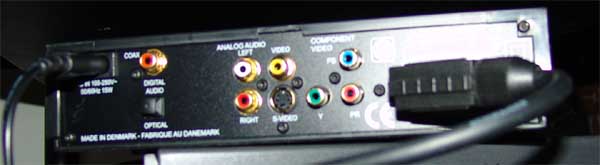

    Sorry, registration is required for that page. here is the copy. I have attached the image of back of player.

  5. 1. SPDIF outputs ENCODED digital audio just as it is on the DVD over a wire. Only difference from the optical is the transmission medium (and of course the connector type which can restrict DVD-receiver mating). Don't ask which is the better of the two! There are serious flame wars on almost all Audio-Video forums caused by this. For normal people both are fine.
    2. ENCODED 5.1 output is NOT sound! If you input it in a speaker - via an amp - you get bugger all. Most DVD players will output a 2 channel sound (to send to your TV or to a stereo amp if you want bigger speakers). They do that by DECODING the digital stream and down-sampling the 5.1 into stereo. They will also have an SPDIF and/or optical (a.k.a. Toslink) connector (for output only). This meant to be input in a Receiver which will DECODE the 5.1 (or 6.1) and has its own 6 discrete outputs with sound (5 are usually already amplified) that you connect to your 5 speakers and to the subwoofer.
    3. Some - proportionally few - players will have a 5.1 decoder built in. You recognize them by the fact that they have at least 7 pairs of sound output connectors (6 for the 5.1 and another pair for stereo). Thus you not need a receiver. It may seem like economy but is it? The sound they output is NOT AMPLIFIED! So you need to buy a 5 or 6 channel amp (depending if your subwoofer is ACTIVE i.e. has its own amp).
    4. While there are such amplifiers on the market, they are rare. Why? Because nowadays Receivers (DECODER + AMP + other stuff irrelevant here) are plentifull. They start from cheap under £200 ones and go to not so cheap £000's.
    5. Another way to use a DVD player with its own decoder - but no AMP remember! - is to use powered speakers. For "room" viewing there aren't many of those but PC speakers are an example of this.
    6. So, if you want to use surround sound your best bet is:
    - the best DVD player you can afford WITHOUT a decoder
    - a Receiver (my advice is buy one that has both Dolby and DTS and also there's more than one "flavour" of each of those e.g. Dolby 5.1 and Dolby 6.1).
    - passive MATCHED speakers (the 5 part of the 5.1)
    - active subwoofer
    7. Do your research on the web before you buy ANY of the above. More expensive TENDS to translate in better quality but not always. Look for "professional" reviews (magazine web-sites) but remember these people do not pay for them and they sure as hell don't take them at home for 2-3 years. Also look for real users feed-back on all of these. I recommend http://www.avsforum.com/ but there are lots more.
    Hope this helps.
    It wasn't me.
  6. OK, you posted the image and review while I was typing.
    This player CANNOT be connected direct to 5 speakers + subwoofers.
    But it does have both coaxial and optical digital outputs (leftmost outputs) so you can buy any reciever (though nowadys most of those have both also).
    But you see what I mean about "professional" reviewers?
    On the "we didn't like" part they say:
    ... We'd like to see the same model one day with component and DVI video outputs ...
    Well, it already has component outputs. These are the 3 ones next to the SCART in the image and it also lists Component Outputs in the Features list above the image. Go figure...
    It wasn't me.
