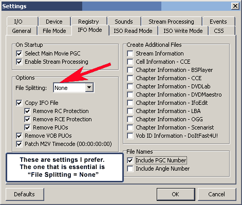

    IFO mode is my preference for doing this. First you need to set up the options in DVD Decrypter so you don't get truncated files:

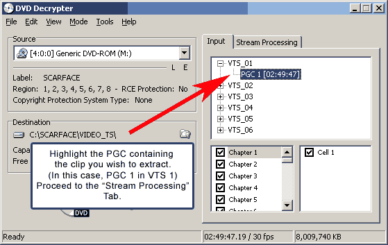

    Then you gotta go through the different titlesets and program chains and find out which clip you wish to extract, and then select it:
    After it's selected, go to the Stream Processing tab, and check all the streams you want and uncheck the ones you dont. For each stream, you must independently hit the DEMUX radio button, otherwise it will give you a direct stream copy by default.

    Heres a crude picture I took from another thread:
