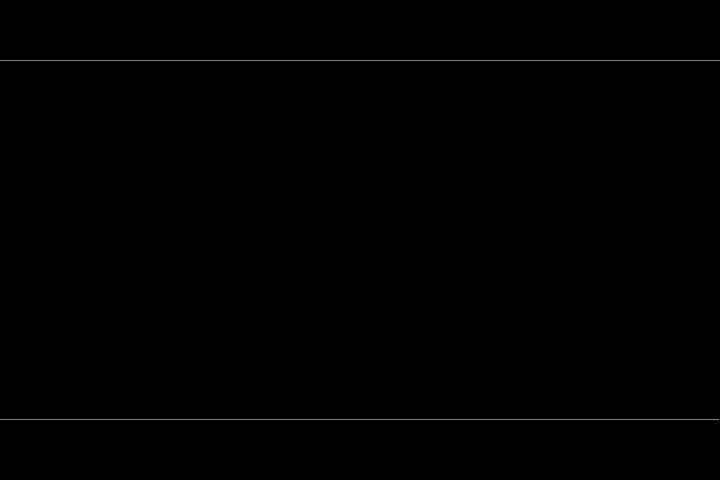

After thinking about it for a while I may have thought of a fairly easy solution: use a logo filter with an alpha channel. Make your logo a full screen black image. For the main part of the picture make the logo transparent. At the very edges of the picture make one scan line 50 percent transparent. If it take two scan lines to get rid of the flicker make one about 66 percent transparent and one 33 percent. For the letterboxes it doesn't matter if the alpha map is transparent or not.
An image like this should work for the alpha channel
Thanks for the help junkmalle! I'm gonna give your solution a try. I'm kinda surprised though, that there are almost no posts, topics, or guides for this kinda problem. You would think that more people would have tried converting a SVD witha 16:9 ratio into DVD format.
Chobo, I ran a little test with VirtualDub and it's logo filter. The logo/alpha channel technique seemed to work. You may need to fiddle around with just how transparent the alpha channel needs to be to get optimal flicker reduction.
