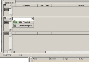

Just create an alternate playlist and have the buttonclick activate the "Playlist1_ChapterX", as opposed to "MovieX_ChapterX".
Have done this many times, works great and you don't have to mess with GPRM/SPRM registers.
If you haven't done Playlists before, you can access it by click in the bottom right area of your Movie Pane (should have an Icon that denotes Playlists).
HTH,
Scott -

Scott, I have no experience with playlists. The icon (on the status bar, right? Looks like a 4x4 Go board surronded by << and >>?) doesn't seem to do anything. Maybe there is some other setting I'm supposed to set.

Should work just by clicking on it.
Here's what you're looking for:
and when you click, here's what it should turn into:
Scott -
Wow, thanks for the screenshot, Scott. That is the button I have been clicking on, but it does nothing for me. Maybe this is because my movie is a single clip with chapters rather than a collection of shorter clips? I'm not sure. In any case, I could be wrong, but I suspect that this method would probably give the same slight stutter that the Cona's solution has.
