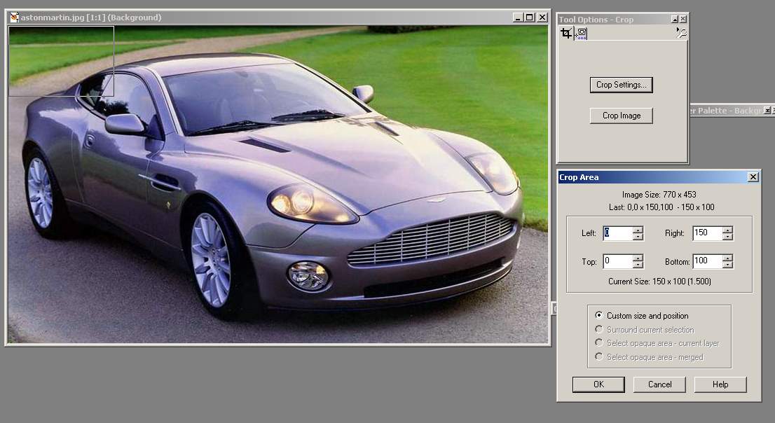

Click on view-toolbars and make sure the tool options pallete is selected.
Select the crop tool.
In the tool options - crop window click on crop settings.
Enter 0 for left, 150 for right, 0 for top and 100 for bottom.
You will then get a 150 x 100 crop box on your image, which you can drag where you want on the image. Then simply click the crop image button. -
Isn't this pretty much what I said?Originally Posted by Craig Tucker
Yes, but I added a pretty picture for those with learning difficulties
