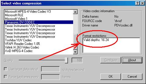

I think i found the reason why.
I used Panasonic DV Codec with DVIO, then changed the FourCC code to CDVC so it would decode with the Canopus DV Codec in YUY2.
I just noticed this:
Apparently, DV codecs are not to any standard!
