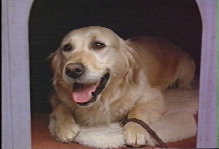

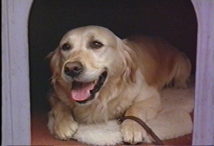

It's a Japanese market Ascii brand with S-Video inputs for each of the 6 inputs. It didn't notice much difference. Maybe I'll do some testing and see exactly how much noise is generated. I just could dig behind my vcrs and computer anymore with all the testing I was doing. Maybe I'll ditch it when I get a permanent setup...Originally Posted by DaveS
Sorry, in a hurry....
Switch:
No switch:
No switch and DNR in "soft" position on VCR:
Does that switch has some kind of DNR? Is it a powered signal distributor/amp? The second frame (straight from the VCR) has the most detail, with a bit more noise. I prefer clarity over a soft picture, but some like the "smoothed" low-noise look.
I was going to describe it exactly the same way. I was going to say the switch resembled my Toshiba VCR when I use the DNR in "soft." It's just a dumb box, not powered. I know you don't have the benefit of the original bitmaps, but with the switch in the path, the picture is actually "bent" or "warped" slightly. I also prefer sharpness over a softer look. My original plan was to use the switch to test my VCRs to find the right setup. But, each of them has it's own strengths and weaknesses. So I left the switch there and never thought about it.Originally Posted by gshelley61
I think that switch is just limiting resolution, no DNR.
I personally like clean video, be it soft or sharpness. Just clean.
