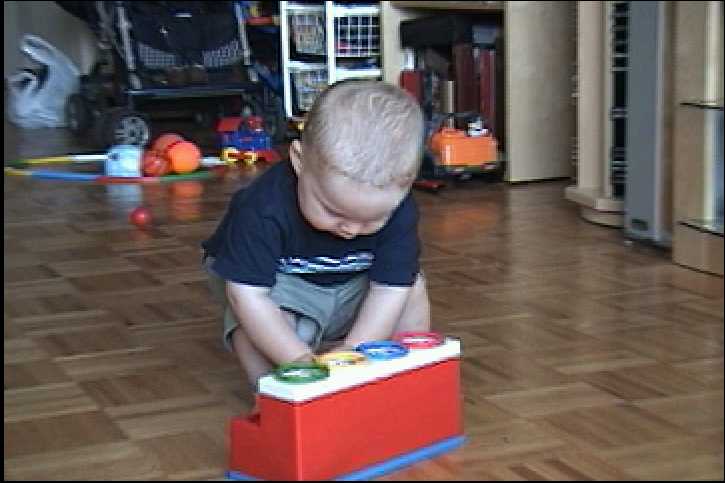

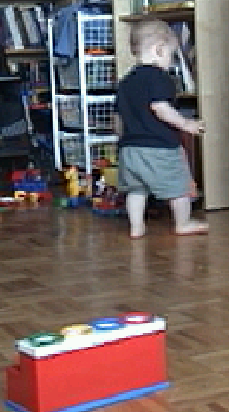

    Just captured my first DV video with WinDV from Sony TRV-22. Attached is a crop of what I see on the screen. You are looking at about 1/3 of the frame and it is very representative of what I see on the screen. Is this the level of pixelation that I should expect or did I (hopefully) do something terribly wrong? Will it look bettre on TV?
    Thank you very much in advance!

    What you see is my Alt-Shift-PrintScreen of the window. The screen is 1280xsomething and I'm viewing the video at "200%".
    To give you a better idea of how much of the frame I shows previously, I'm attaching another image with the full frame (different frame, I coudn't find that one...) Nice underware shot!
