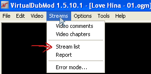

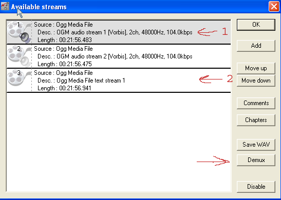

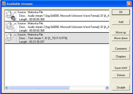

1- Open you OGM file in VRDubMod and go into Stream >> Stream List.
2- In the new window you should see something like this:
Select the first Audio Stream and press on Demux and save it as .ogg . Then select the Text Stream and press on Demux and save it as .srt.

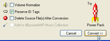

3- Now select all the .ogg files, right-click and choose Convert To(Must have Audio codecs installed to convert http://www.dbpoweramp.com/codec-central.htm ). Choose MP2 (Must have Audio codecs installed to convert http://www.dbpoweramp.com/codec-central.htm )or MP3 and follow below:
Make sure you choose MP2 and not Bwf MP2 if you decide to use that codec. Frequency should be 44100Hz and bitrate can vary(i choose 256 for MP2 and 160 for MP3)
Note: You can repeat step 1 and 2 for all your OGM files and then select them all to convert them all at the same time.

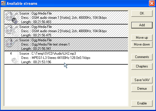

4- Once that is done, Open your OGM file in VRDubMod again.Now go into Streams >> Stream list and select each stream and press on Disable. Then press on Add and add the mp3 that corresponds to your file. When your done it should look like this:
5- Now close that by pressing OK. Go into Video and select Direct Stream Copy. Then go into File and choose save as. This process shouldn't take long.

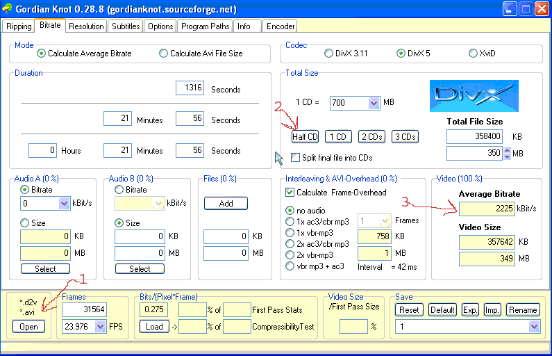

6- Open Gordian Knob and under the Bitrate Tab press on Open at the bottom to open your AVI. Since this guide is for anime, you can usually fit 2 episodes on a 80min CD in the Total Rate area make sure you have 700 in the 1 CD= box and click on half CD button so your Total File Size is 350MB. Make sure the selcted Codec is DivX 5. Now look at the Video(100%). Under Average Bitrate take down that number because you'll need it for later.
In all it should look like this:

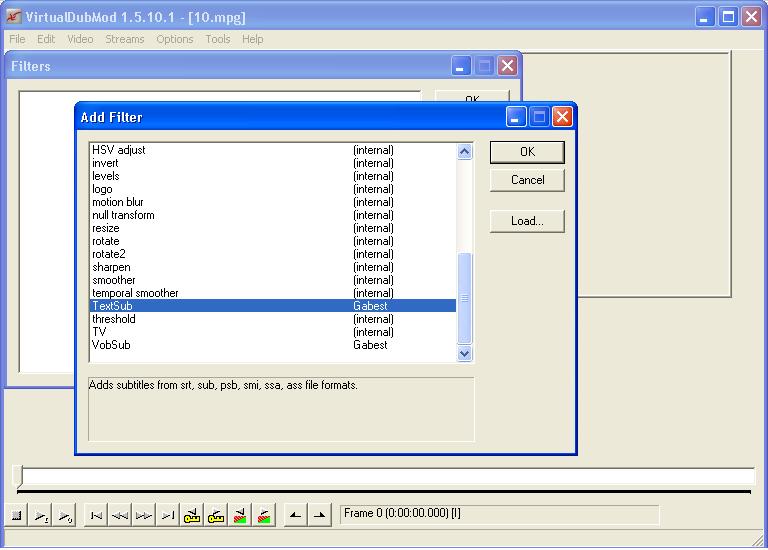

7- Open your AVI in VRDubMod and go to Video and select Full Processing Mode. Still in Video select Filters. Now you must add the TextSub Filter, but since it aint there by default, you have to go get it. You need to make sure that you have VobSub installed(comes in K-lite Codec Pack or just go download it). In the Filter screen, click on Add, then click on Load. Change the file type to DLL and go find the vsfilter.dll in C:\Windows\system32 and open it. Now in your list of filters you should see TextSub. Click on it and go get your .srt file that you Demux in step 2.

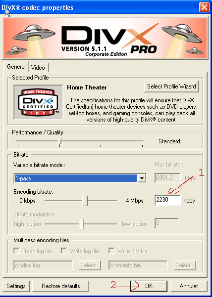

8- Now that thats done you go back under Video and select Compression. In the list, choose DivX Pro 5.1.1 and click on configure in the right panel. In the Bitrate section put you Average Bitrate that you got from Gordian Knob in the kbps box.

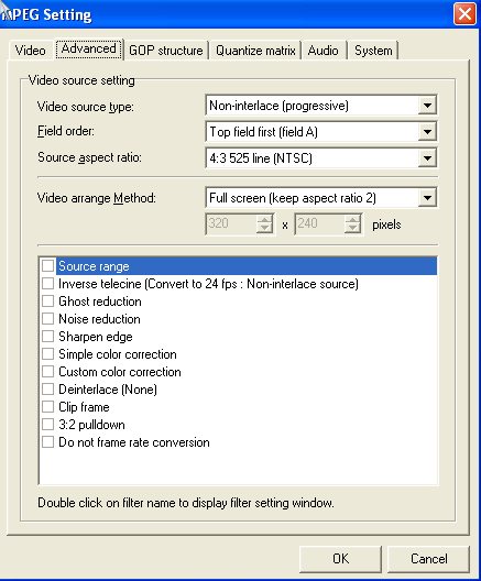

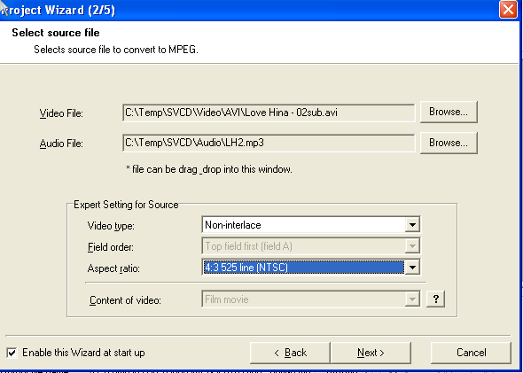

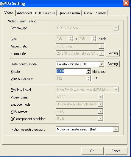

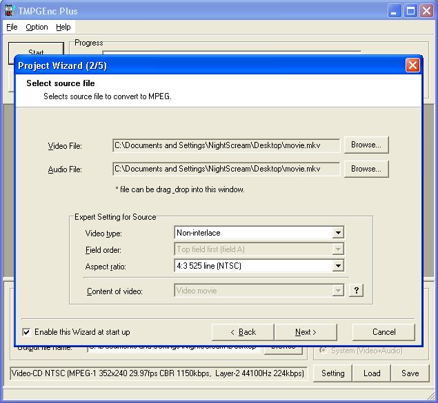

10- Once you AVI is done check it out to make sure you still go good quality. Now open TMPGENc Plus and in the Wizard choose NTSC Film under SVCD. In the next screen, under Video File choose your AVI. Under Audio File choose your mp3 from step 3 by change File type to all files.
The reason you have to use your Audio file instead of just using the Audio on the AVI is because TMPGENc doesn't accept DIVX really well.
For the TMPGENc settings I will give you what i used but that doesn't mean that it will work for you.

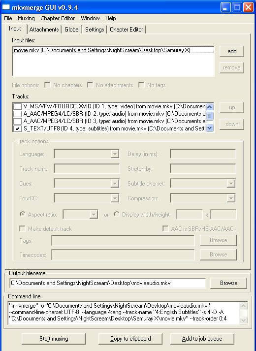

3. Open the the mmg.exe (located within the mkvtoolnix and extracted to a folder with the runtimes). Open the file "movie.mkv" and clickout the chekmarks in the track list. Ex, if you want the Korean language clickout the Video, english language and the subs. Click on "output filename" to save it somewhere as "movieaudio.mkv" and click on "Start Muxing".
4. Open TMPGEnc Plus 2.5, in the "Project wizzard" hit Next,
a. Open the "movie.mkv" on the "Video File".
b. On "Video Type" put it in "Non-interlace" and in the "Aspect Ratio" on "4:3 525 line (NTSC)" and convert it to .mpg

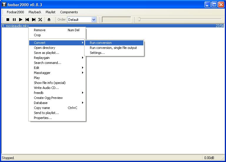

5. Open Foobar2000 0.8.3, click on "Playback" then to "Add Files..." add the files "movieaudio.mkv" to the list, right click on the file, click again on "convert to" and save it somewhere as "movieaudio.wav" Note: the audio will be converted to .wav so TMPGEnc could understand it.

a. Click on "Video->Filters". Click on "Add" then "Load", change "Files of type" to "Windows Dynamic-Link Library (*.dll)" find the "VSFilter.dll" at "C:\Program Files\Matroska Pack" Then click on the "VSFilter.dll", click on Open.
b. In the list of the "Filters" click on "TextSub" then "Ok". Look for the File named "moviesubs.srt" then hit "Ok". Now you have the Subs within the movie file.

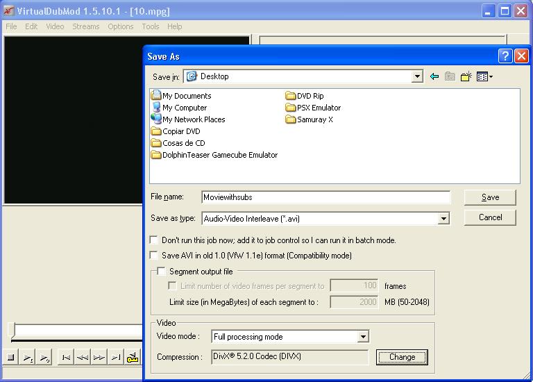

c. Click on "File-> Save as" save it somewhere as "moviewithsubs.avi", at the "Save as Type" change it to ".avi".

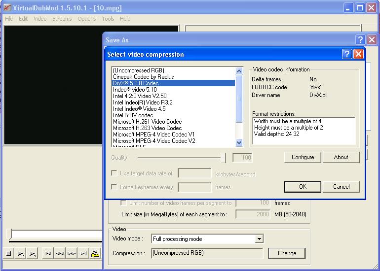

d. Click on "Change" (Right side of "Compression"). Select "DivX 5.2.0 Codec"
then hit "Configure", at the "Bitrate" Put it at Maximun, then "ok",

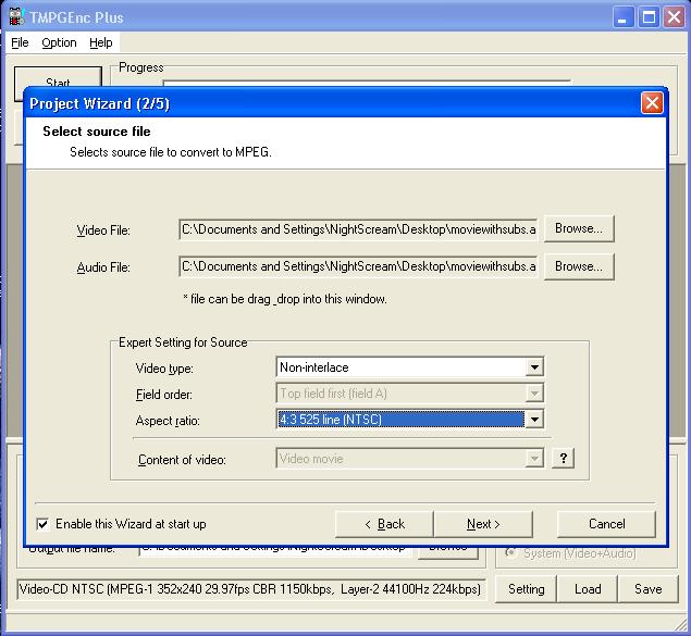

7. Open TMPGEnc Plus 2.5, in the "Project wizzard" hit Next,
a. Open the "moviewithsubs.avi" on the "Video File"
b. At "Audio File" hit on "Browse" and click on "movieaudio.wav".
c. On Video Type Put it in "Non-interlace" and in the "Aspect Ratio" on "4:3 525 line (NTSC)" and convert it to .mpg

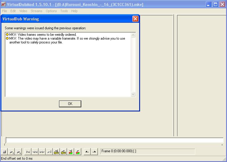

I got one question, in some MKV files when you open it says,
"MKV: Video frames seems to be weirdly ordered."
"MKV: The video may have a variable framerate. If so we strongly advise you to use another tool to safely process your file."
And you can do shit with the MKV file. The only thing you can do is to convert it with TMPGEnc to MPG.
If you know something, let me know. Thanks...
PS. And sorry about posting something on you post, I'm kind of new on posting messages and replying them. I just like to help anyone like you guys helped me. So THANKS! -
VirtualdubMod is meanwhile not capable to handle MKV files anymore. If your MKV will open in VirtualdubMod, you are very lucky, but i wouldnt write a Guide based on it, because it will definitely fail on say 60 - 70% of the MKV files out there, especially those with RV9 video ( which is using VFR = Variable Framerate, like most modern video codecs ).
