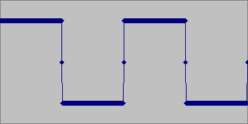

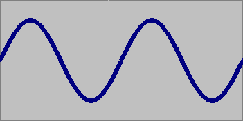

    The reason I mention the process is that while two signals may have the same peak level, they don't necessarily have the same loudness.
    Here's an example which assumes I've already normalized:
    This is a sine wave with a peak of 0dbFS:
    and this is a square wave of the same frequency with a peak of 0dbFS:
    These both have the same peak level, but the Square Wave will always sound a good deal louder. Why?
    Because of the additional energy of its harmonics. Common sense would also tell you that if the peak level stays at that loud point for a longer period of time, it's going to sound louder than one that is intermittently or occasionally loud.
