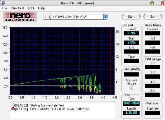

  5. I ran Nero Speed Test on the burnt movie DVD and it came up with some bad results....

  7. I checked the DVD+R Disc with Nero InfoTool, and also DVDInfo Pro, and they both revealed the discs supported writing speed is 2.4X, the Media is printed with 4X Support....or is this the supported speed by my burner
  8. That's probably your problem right there, if the discs are being burned at a higher speed than they are actually rated for, I would imagine that could cause problems.
