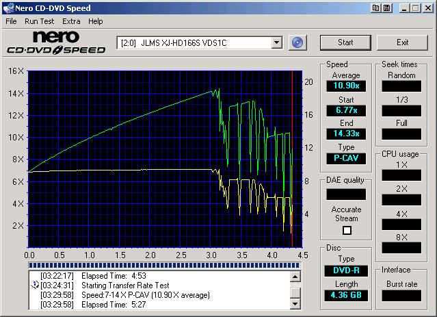

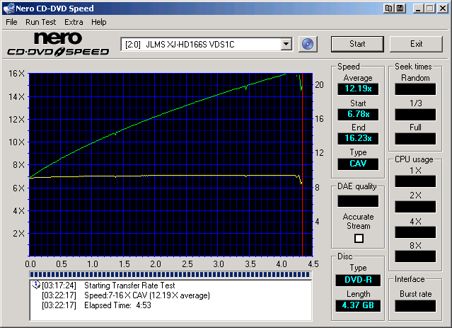

  20. Get Slack disturbed1's Avatar
    Apr 2001
    init 4
    Here's the difference between TAIWAN and JAPAN Verbatims. I would guess the same can said for TDK also.
    Both discs were burnt on a NEC 2500 with the newest STOCK firmware. Note that the max burn speed is 8x, but I selected 4x for both discs.
    which is which
  21. I tested a disk in my Pioneer 107D and it worked fine, so I'm tempted to conclude that these are good quality disks. I'm also tempted to try to pick up another couple of spindles before the sale ends on Saturday....
