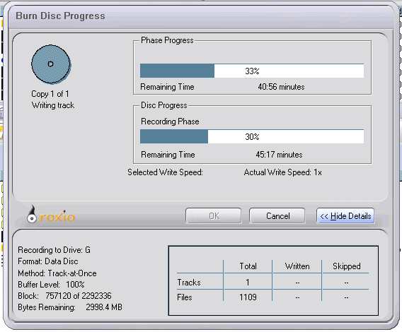

    I'm trying to back up some files from my HD on a DVD-RW, the problem is: in 14 hours, it has only burned 30% of 4.7 GB! Ok I can understand that burning a DVD at 1x might be slow, but THAT is really slow and totally passed the remaining time indicated. I burned another DVD right before this one and it took about 4 hours (with same burner, same options, same speed, same type of DVD). I interrupted the burning 'cause this is going crazy and I thought it was OK since it's a DVD-Rw, but no! When I tried to erase the DVD, I got a message saying the DVD is already blank, but when I actually tried to burn something on it, it tells me to insert a blank recordable disc. So I erased the DVD, but it's still not a recordable disc... Before I insert a new DVD, I just want to find out what was the problem so I won't get it again.
    I'm using a Plextor PX-708UF connected through USB 1.1 with Roxio Easy CD & DVD Creator Home 6 that comes with it, I selected the option PowerRec (which was recommended). Here's a screen cap:
    Any help appreciated, thanks!

    I just took a look at a page about the Plextor PX-708UF. The specs call for connection to Firewire or USB2.0. If you've got it connected to USB1.1, that is probably your problem.

  4. @broadway: I know, but it's also compatible with USB 1.1 though it's slower but not THAT slow.
    @daredevil: I used a Memorex DVD-RW (they may not be the highest quality, but they can't be that bad right? Unless it's a unique case with my DVD). I'll give it another try and if it's still not working properly, I'll take it back.
  5. If you have a friend that has a new machine try it on a USB 2.0 port and see if it runs better.
    Or, spend $29.00 and buy a Fwire port and try that.... will be faster than USB

    the problem is the USB 1.1, the burner is fine, I would suggest you get a FIREWIRE CARD and use that instead of a USB PORT CARD. there are more compatiblity issues when using USB PORTS. FIREWIRE is better to use less compatiblity issues with hardware and software. do a search in here & you'll see that some have had compatibilty issues with USB PORTS for EXTERNAL BURNERS. take a look at this thread in cdfreaks.com:

    BTW, I used Nero disc-info feature to see my DVD-RW and it DOES have a session on it, I don't know why Roxio didn't erase it correctly.

  9. update: I just got an answer from Plextor tech support (kinda impressed, they replied within 4h and didn't beat around the bush...), well apparently Memorex is not on their compatibility list (though I did succeed to burn my previous DVD) and they also told me what I already knew (USB 1x is slow yadda yadda yadda, get a USB 2x). Ok fine, guess I'll have to spend some money again igh: (probably on a FireWire instead). Wouldn't the world be a whole lot easier if everyone did the same thing, then we wouldn't have those d*mn compatibility problems!

    I've burned DVDs at 1x over ethernet 10 and the speed is close to USB1.1. The buffer underrun repeatedly activates but it only takes about 1:20 to burn a full DVD that way. There's something else going on besides the interface if it's only 1/3 done after 14 hours

  15. Ok guess what? I gave it another try with a new Memorex DVD, same files, same options, same program, didn't touch anything, and as it turns out, the burning was completed in 2 hours. I think I'm going to buy some new DVDs compatible with my writer this time and do some tests to see if the problem really comes from the DVD. If it still doesn't work correctly, then I'll reinstall the software and get a FireWire. Thanks everyone for your help!
