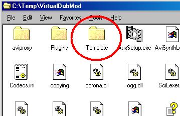

    Inside the VirtualDubMod directory is a folder named "templates".
    You can open them with notepad to view the contents;
    (1)To create a new template simply open NotePad and past the text (without the dashes);

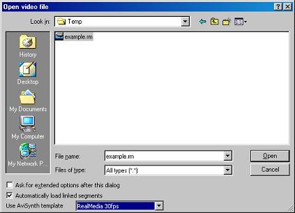

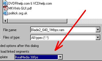

    To open a RealMedia file in VirtualDubMod, set "Files of type" to "All files", and browse to your source file. In the lower menu "Use AviSynth Template", choose your newly created template.
    *DirectShow usually has no problem displaying RealMedia through Windows Media Player (or MPC), but AviSynth requires that the framerate be included before it will frameserve *.RAM.

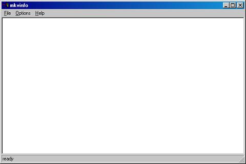

    In the package MKVToolnix is a command line tool "mkvinfo.exe" that HAS a hidden GUI built in. To access the GUI use a "-g" at the command line or make a shortcut with;
    to produce;

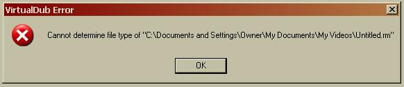

    I followed your guide, and got this error:
    Hello.

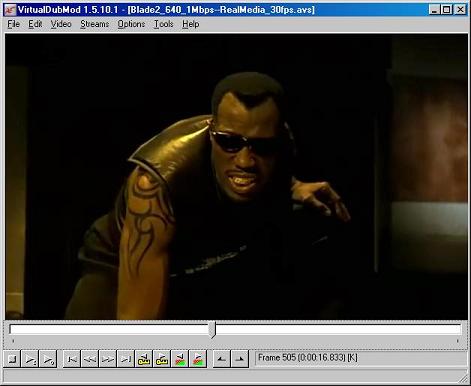

    Well, i thought it might have something to do with difference in *.rm files so i downloaded a few off the web..............Mine still works fine, i don't know what to tell you.
    Try this one; http://www.bunkus.org/videotools/mkvtoolnix/samples/real/VC-RV40/Blade2_640_1Mbps.rm
    Here's what i see;
  5. Originally Posted by Tommyknocker
    I see the problem, if VirtualDub didn't like anything, it wouldn't like a file with a *AVS file extension. Your pic shows VirtualDubMod has identified a *.RM file extension.
    You couldn't have loaded the template (see bottom menu in blue)

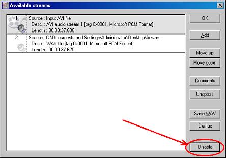

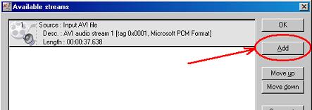

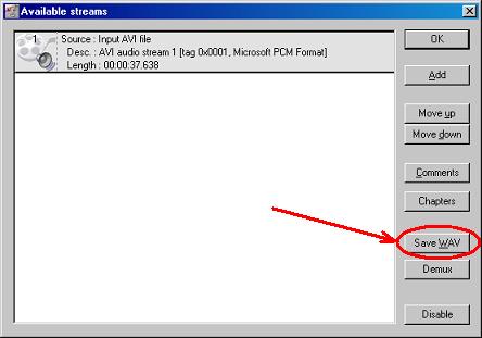

    As i said in the "observations" section of the guide, audio sometimes does not work correctly unless you extract the *.WAV file first and then load it as your audio source. (it looks like i only said it for TMPGEnc, sorry)
    If the audio will play through your media player then try this;
    1. Reopen the file by browsing for the *.AVS file.
    2. Under the Streams Menu, see if the audio appears.
    If the audio appears then;
    3. "Save WAV"
    4. When the "Save WAV" is finished, reload the WAV file as audio source.
    5. Now highlight the original audio (Gray), and select "Disable".
    6. Click "OK", and try your project again.
