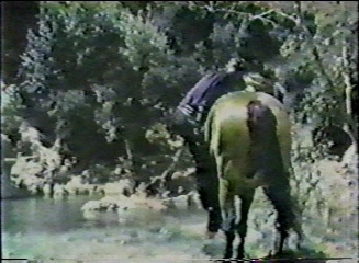

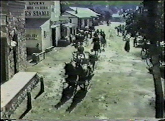

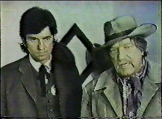

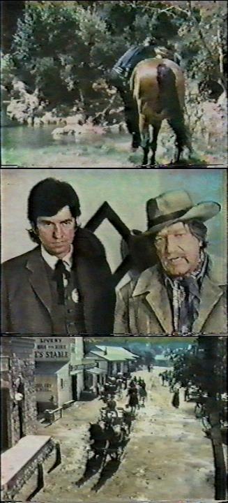

Here are some screen captures.
I think the color is fine. It's juse that "washed-out" look.
Allen -
I think you'd be best off just leaving it go. For VHS, it doesn't look all that bad, and to expect it to get any better is unrealistic.
