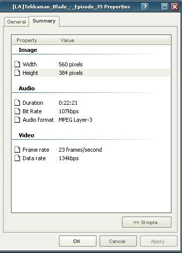

  1. Hello, i have some divx file that i want to put on dvd as svcd or vcd to get multiple episode on one disc i was hoping for svcd but looking at the file i notice it has odd specs. What format would be best to chage this file to to do what i want, i attached a jpg of all the files spec. Thanks for anyone that can help.

    I'd go with SVCD 480 X 480. You'll have black bars top and bottom.
    Either that or go CVD and use 352 X 480.
    Don't forget that you have 23.976fps, so you'll need to inculde a 3:2 pulldown so it palys correctly.
    If in doubt, Google it.
  3. Now how would that look knocking 384 up to 480? i dont really mind the black bars as i usually get my movies in Widescreen edition so im used to it. The video is of some Anime in case that matters, i heard things about dealing with animation and framerates.

  14. Member holistic's Avatar
    May 2001
    here & there
    Video - Data Rate 134 kbps ?
