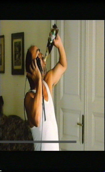

    Unfortunatel, i get this annoying, stable, semitransparent black line (about 8 pixels high) across the bottom screen..I'm thinking it's a faulty unit..
    I'm taking an estimated guess that it isn't any Macrovision leftover..
