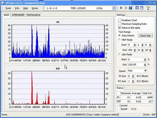

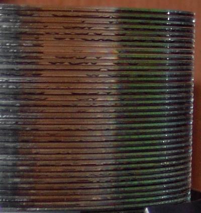

How do you screw this up? You rip the DVD with DVD Decrypter (file mode), then you open DVDShrink, choose your main movie, audio and subs (re-author mode) then you back it up (check deep anylisis). I've buned with Nero and with CopytoDVD with the same results. Like I stated before, the only way around this problem (so far) has been to use DVD2one. Is it possible that surfing the net while DVDshrink is running is causing this? Is it possible that DVDShrink relys on some other application or encoder already installed on my machine that needs updating? I really wish I could use Shrink instead of DVD2one, I like it better. But evey time I use it I get crap results. Does anyone know where I can get an older version? Is it possible that Rima sold me fakes? I'm attaching a pic of the TYudens (YUDEN000T01). They have globs of plastic (or whatever they coat them with) around the edges. Is this normal? Seems to me that it would throw them out of balance.Originally Posted by HAMP

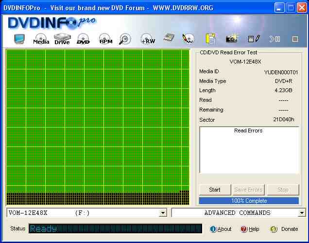

Is it possible that it's just a cheap burner (ARTEC 12X VOM-12E48X RTL)? I just tried some Maxell -R's (TYG01) and the problem is 100x worse. I've already spent more $ trying 3 different brands of media than what I paid for the drive. So I guess I'll just replace the drive. Maybe I can pawn this one off on my brother!Originally Posted by jimmalenko
