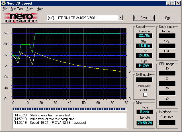

  6. As a footnote to my last post, here are some example graphs that show my point about partial (or zoned, as they call it) writing speeds:
    http://www.cdrinfo.com/Sections/Articles/Specific.asp?ArticleHeadline=Sanyo+CRD%2DBP15...%2DRW&Series=0
    http://www.cdrinfo.com/Sections/Articles/Specific.asp?ArticleHeadline=Mitsumi+CR%2D480...ries=0&index=4
    http://www.cdrinfo.com/Sections/Articles/Sources/LiteOn%20LTR-24102B%20CD-RW/images/cd...write-test.gif
    These generic examples may help you understand the principles a bit better.
