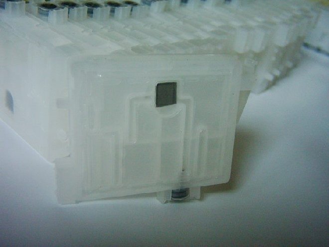

  13. hey eldorado,
    with the help of this forum you now have the easy part out of the way. the best part you are still to face. there are plenty of clear cartridges on the market suitable for CIS's but the hard part is finding a good quality one.
    i can be your saviour if you so desire and save you the legwork (and expense) of trialling all the sh1tty brand units on the market. i have both auto reset (always read full) chips and also clear cartridges available. if you are interested let me know and we'll talk more.
    i've attached a picture of the cartridge for you...
