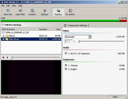

I almost have the same problem, but mine can't even make it to ISO
I rip dual layer to my HD with DVD decrypter, and use DVD shrink to compress it to 4.7GB. When DVD Shrink open it folder containing the dvd, the meter of size shown more that 4.4GB (shown in red color), even in default setting where the size ratio level is on "automatic".
Even the scroll bar is at the lowest level. (Far right)
So i can't even compress it at all. Is there any way to fix this?
the only way for me to do is to remove all the audio file.
(which is silly)
Here is my dvd shrink capture
BTW, my DVD shrink is ver.3.1.7.6 ( i think is the latest)
Thank you very much for your time -
