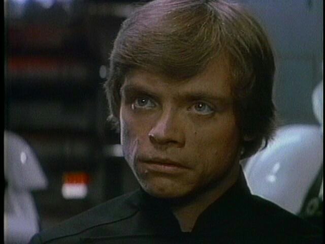

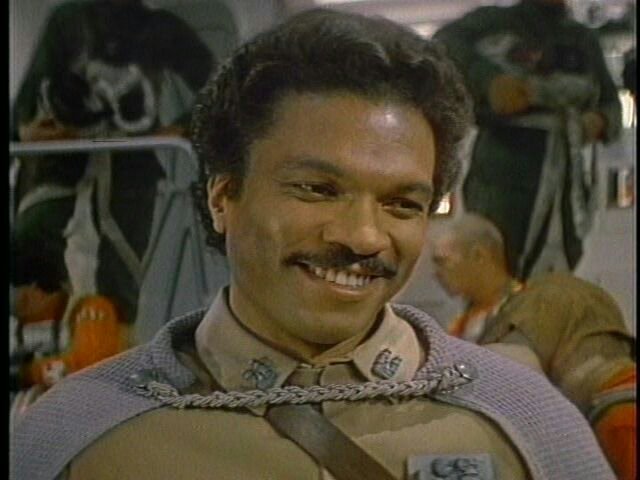

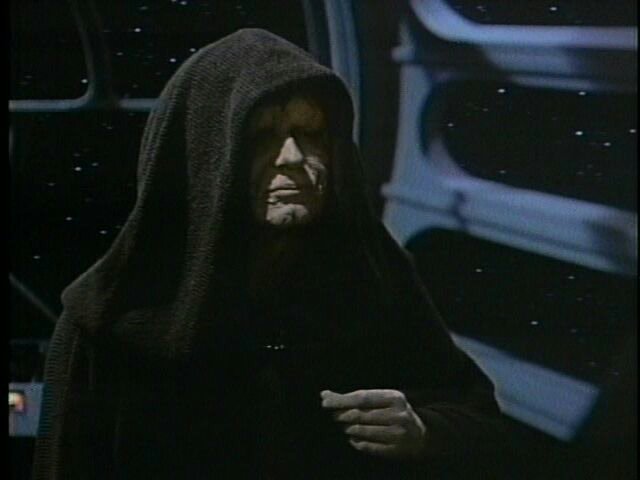

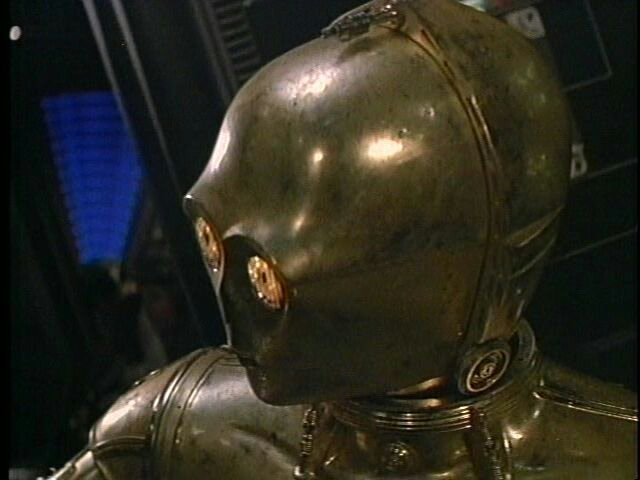

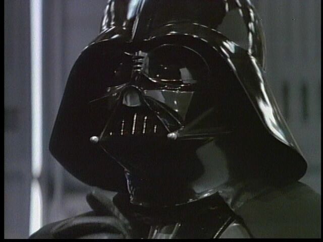

Here's a few test frames I captured last night... I'm using the Pioneer CLD-D704 laserdisc player (composite out) running through the Vidicraft Detailer III (Detail, Sharpness, VNX and Black set at about 1/3), then through the Sima SCC Pro Color Corrector to adjust the black level, chroma and luma (Brightness, Color and Contrast). I also ran the signal through the Vidicraft Proc Amp set on Bypass so I could use the luminance meter for more precise luma and black level adjustments.
Composite in to the JVC DR-M10SL, SP (2 hour), DVD-Video format recorded to DVD-RW.
Samples are from the mid-80's CBS/Fox Return of the Jedi 4:3 pan and scan CAV laserdisc with digital audio. PQ on this release is fair (it has some pretty noticeable video noise).
