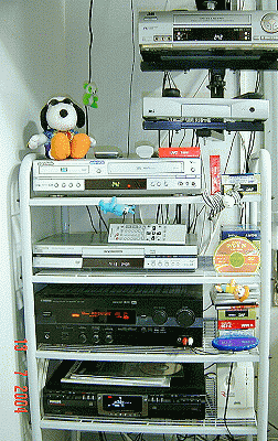

    I have a Pannasonic E50 and I record 1 hour everyday.
    When I finish recording I always remove the disc and it is always hot. Noticing this, I started cheking the top of the recorder's case. It is always pretty hot after 30 minutes operating. My recorder is set on a open metal rack. It has lots of air space under, over, some on it's right side and plenty on it's left side, and 6 inches of free space behind it. After that there is the wall of my bedroom. Right now it is Winter in Brazil and although Rio de Janeiro is a very hot city, temperatures are around 65-70F right now. Although I keep my room at slighty higher temperature for confort sake, the recorder is very ventilated.
    Do you think I should worry about this heat issue ? The recordings all come out perfect, and I notice the heat cools off in less than 10 minutes after I shut the recorder off.

    I wouldn't worry too much about the heat with the setup you have, which is nearly ideal. It's normal for the disc to come out warm to the touch.
    Same with summertime temps there - if it isn't giving errors, then don't worry about it. Remember that electronics run warm and it's perfectly normal.
