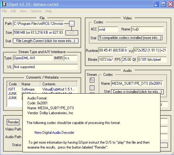

Hi I have a Xvid avi with a DTS audio track. I am trying to burn it, but i can't find anyway to convert it or even play it. Any Ideas? Thanks

Hello and thanks for the help. I don't really care if i can't get it to play on my computer because i am trying to make a svcd out of the xvid file. I just need to figure out what program will be able to convert it to an svcd. Gspot said I have the codec installed, but i still can't get it to play in anything. Anymore ideas?
