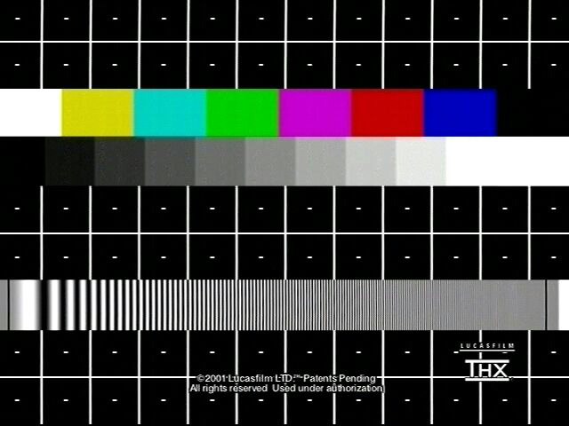

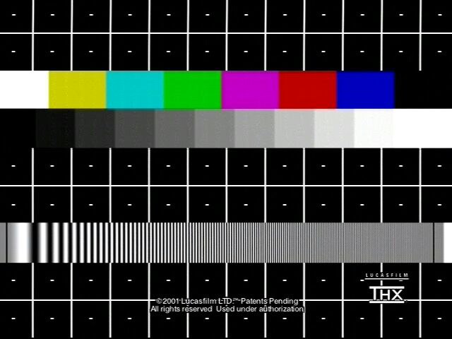

    Here's the test: I played back THX DVD test patterns using my Panasonic E50, ran the s-video out to my AverMedia card, captured an AVI, etc.
    Then I ran the s-video out from the E50 in to the JVC and recorded the same test pattern DVD material to a DVD-RW. I then took the DVD-RW from the JVC and played it back in the Panasonic, capturing to the computer again. Oh, and I used SP (2 hr) record mode on the JVC.
    Original THX DVD test pattern played back on Panasonic E50:
    Same pattern recorded by the JVC, then played back on the Panasonic:
    On the test patterns, the difference is slight, most noticeable at the light end of the grey scale. Don't forget that you have to position each frame in the same place on your monitor one at a time to compare fairly (especially with a flat panel LCD).
    One nice thing this points out, though... the clarity and accuracy of the recording is extremely good. Practically identical to the original.... even the small lettering at the bottom is very clear and easy to read. Maybe those folks that ask us about recording from a DVD player to a DVD recorder are not so nutty after all! The result here is pretty darn good.

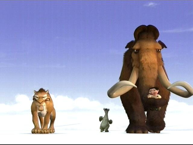

    Here is another frame that is more telling... first the original:
    Now the JVC recording played back on the Panasonic:
    Again, the recording is slightly lighter - most noticeably in the clouds/snowy horizon area. BTW, the vertical lines are some type of noise I always get when I capture with the AverMedia card (one of the reasons I capture with the DVD recorder now).
    OK, so there does appear to be a very mild lightening effect with the JVC recorder. It is probably caused by the pre-encoding "DigiPure" enhancement circuits and filters, which are there to improve poor picture quality and reduce video noise. I would hardly call the results "washed out", though. IMHO, YMMV

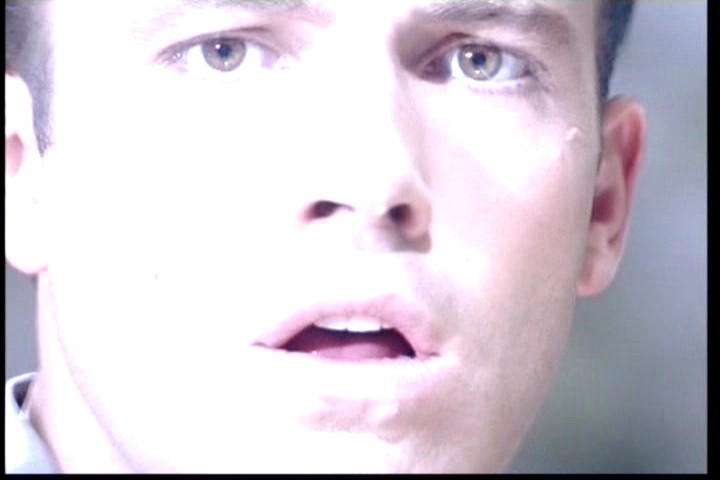

  12. Here are a couple of frames from PayCheck(DSS as the source), one from Tivo and the other from JVC:
    TiVo (Recoded at Best 8.75Mbps VBR 780x480)
    JVC (Recorded in XP mode)
    The problem with the JVC is not just with brightness but lack of contrast too, this may not be the ideal source but just an example and it's worst in SP or lower modes.
  13. Again, a slight difference (the JVC recording is a bit lighter). That sure is one bright frame sample, though!

  14. Originally Posted by gshelley61
    BTW, is that movie any good? Just curious as I'm a big Blade Runner fan...
    In some other movies like The Cooler the problem is more visible, but I don't have a clip right now to show you.
    Paycheck is so so, this is clip from PPV on Dish which has a signal that's bit too bright for my taste, maybe I should try the original DVD.
