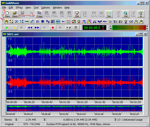

First we need to load the avi into Goldwave to get the audio of the file. Since we will be changing the frame rate of the video we need to also change the frame rate of the audio. To do this open Goldwave and then pres the "Open" button (step 1) or go to "File --> Open" and then select the avi you want to convert. Once it has finished loading the file we need to save the audio as a 16-bit 48k Stereo PCM WAV file. To do this we go to "File --> Save As" (step 2) then select where you want to save the audio. Remember where you saved it so that you can find it again later.

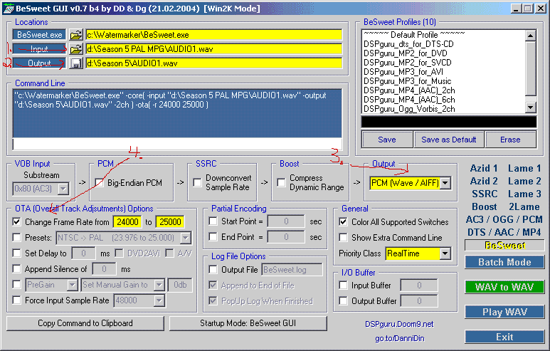

Next we need to convert the frame rate of the file we just saved out with Goldwave. For this we will use BeSweet (make sure you have the latest beta version of the BeSeeet.exe and BeSweet Gui) Open BeSweet Gui and select "BeSweet GUI" as seen below
Now we need to set BeSweet to save our file as a 16-bit 48k PCM WAV with a frame rate of 25fps since that is the native PAL fram rate. To do this we need to first load the file we saved with Goldwave into BeSweet by pressing the folder icon next to "Input" at the top left (step 1). Then we need to tell BeSweet where to save the new WAV file. BeSweet might not rename the file properly so I suggest saving the new file to a folder that is not the same os the "Input" file folder. Go to the folder icon next to "Output" and find that folder (step 2). Underneath the "Save" button you will see a yellow drop down menu. Find "PCM (WAVE / AIFF)" in the drop down menu and click on it (step 3). Now all we need to do is put a check mark in the box next to "Change Frame Rate From" an in the first yellow box enter 24000 in the second enter 25000 (step 4). Now you might be thinking "my file isn't 24000 fps I will use 29.970 fps but that is wrong! You will see why in a minute.

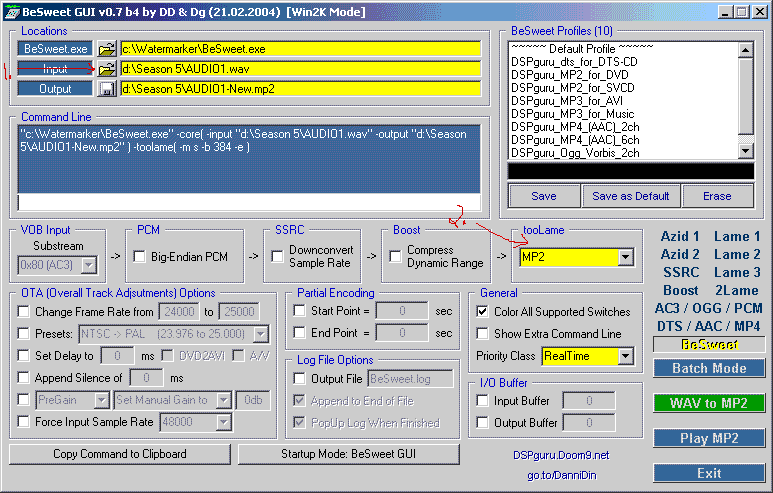

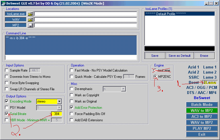

Now we need to make the MP2 or AC3 file. I suggest using MP2 because it is smaller and allows you a better bitrate on the video for larger movies. If you are not worried about file size and want to use AC3 to get the best quality then I am sure you can figure that out. Below I show how to make an MP2. First we need to load the WAV file we just did the frame rate convert to with BeSweet (step 1). You can select where to output but since the file extension will be different it won't matter this time if you save it to the same folder as the source WAV. In the drop down below the "Save" button (step 2) you need to find MP2 and select it. Make sure the "Presets:" box is NOT checked anymore! This is very important because it will throw the audio out of sync with the video in the end.
Now Click "2LAME" on the right hand side (step 1) and make sure you have set everything as it is in the picture below! If you want to lower the bitrate I would not recommend going any lower than 128 (step 2) as this will be very apparent when listening to it later! Make sure you use "MP2ENC" not "tooLame" (step 3).
Now you can output the MP2 and we are finished with the audio!

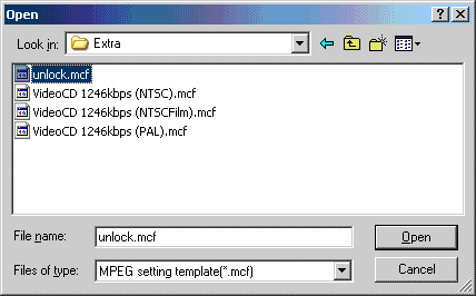

Now we have to load the UNLOCK template. So again CLICK on LOAD and open the EXTRA folder then load the UNLOCK template (unlock.mcf)
SELECT the correct file (highlighted in my example above) and CLICK on OPEN. We are now again back to the main "page" of TMPGEnc Plus.

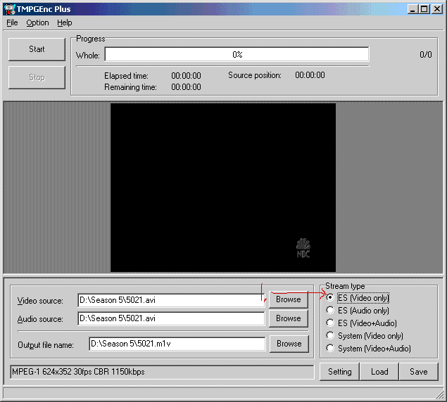

Make sure you now click on ES (Video only) under STREAM TYPE (step 1).
This is an example of what you should see (note in this example I'm using an AVI file as a source file):

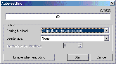

We want to move to the ADVANCED tab at the top. Then we need to double click where it says "inverse telecine (convert to 24fps : flicker prioritized)" Then click on the "Auto-Setting" button. If your source is already 23.976p and has no interlace frames then I would definately use the settings below. If you have an interlaced file you can choose weather or not you want to deinterlace or not (I recommend that you never deinterlace but thats personal opinion) Then press the OK button.

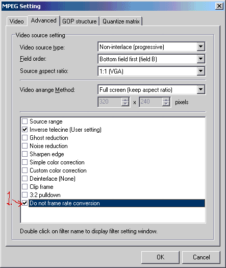

Now that we have changed the frame rate we need to change a few things under the advanced tab. These settings are for a 16:9 avi file but hopefully you know enough to set them for the file type you have. Or just leave the defaults and it should be fine.
MAKE SURE YOU HAVE A CHECK MARK IN THE "DO NOT FRAME RATE CONVERT" BOX! Your screen should look like the one below!

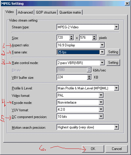

We need to set the video output to match the input source. Do not change "Stream Type" or "Size" the defaults are correct! Under "Aspect Ratio" you need to choose the original aspect ration of the file(step 1). If you do not remember what it is then I suggest you get AVIcodec which will tell you. For frame rate it will say 24. We need to change that to 25 (step 2).
Rate Control Mode is where you tell it what kind of compression you want to use. I suggest using "2-pass VBR (VBR)" for all work done in TMPGEnc. (step 3)
Encode Mode should be "non-interlace (progressive)" (step 4).
DC Component Precision should be "10bits" (step 5).
Now you can click "OK" at the bottom.

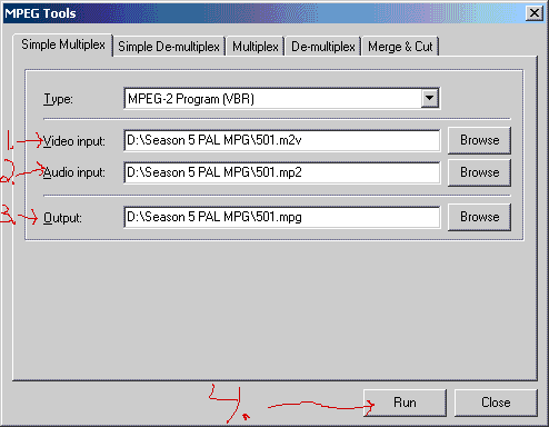

Once the Video has finished go to "File --> MPEG Tools" then open the M2V you just made (step 1) open the MP2 audio file we made earlier (step 2) and tell it where to save the MPG file (step 3)
