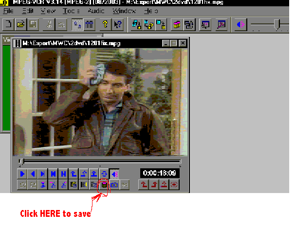

I have a FAST and lossless fix for out of sync material! I got these married with children vcd's. Every one was going out of sync upon demux/remux. So i tried womble mpeg2 vcr (suports mpeg 1 and 2 so dont worry) It works! The new file can be properly demuxed and remuxed without reencding!!
First load the mpeg in womble. Drag the mpeg file into womble window. (Cant be a bin file and possibly not a dat file, sorry)
next browse for or type in a new filename and path, and click SAVE. Chose mpe1 program stream or mpeg2 program stream. no need to make a vcd or svcd stream at this point.
Now your new file will remain in sync during the demux and remux, and womble will not reencode the file if you chose the same mpeg 1 or 2 the source was. What I am guessing is happening, is womble is parsing the PTS data and reencoding only the frames that would otherwise be missing. thus the final output file truly has the exact right amount of frames and will remain in sync.
You will notice it writes out the new file incredibly fast, due to its not having to reencode the whole thing. Believe me, I was rather excited when I tried this and it worked. I have 55 mpgs like this one that ALL went out of sync, and the thought of reencoding all of them made me want to cry. Also note, womble is an excellent mpeg cutter too, you can cut stuff out if you wish before you write a new fiule, but this guide wont get into that. It can cut mpegs that have mpeg audio and ac3, PCM support last time I checked was not available, but maybe is now who knows. Enjoy and reply if this helped you I'd like to know if people got helped by this.
