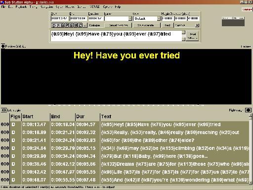

Anyway, this is how my lyrics looked after being formatted in SSA Karaoke Style:

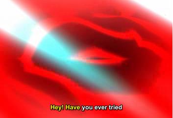

And of course, after adding them into a video with the music using Virtual Dub and the TextSub filter:
I would post a link to it, but my mpeg version is about 120 MB. I may convert to wmv later to give a video version you can look at, as this karaoke thing is pretty cool.
