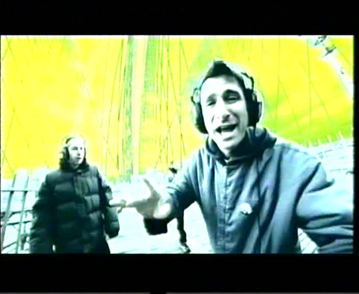

I've decided to make some screen caps to better exlpain my situation.
Here is what I've been recording for the past few months:
Non Anamorphic 704x576

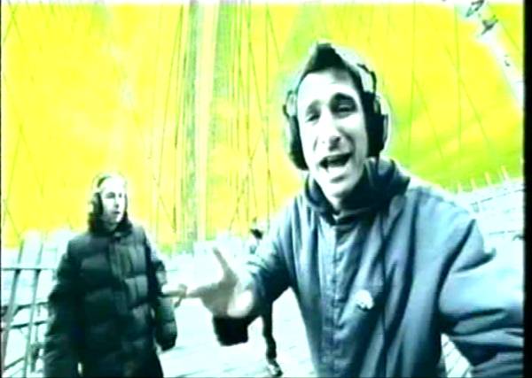

And here is a screen cap of how I can record it, so that my TV will stretch it out.
Anamorphic
Now, how can I stetch the above image back out, so that I can view it with the unsquished way on my computer and with black bars on a 4:3 TV, and at the same time, keeping it in the above way, so that on a 16:9 TV, it will be anamorphic. -
If you record at Full D1 PAL resolution (which is 720x576 but 704x576 is also ok) then to make it anamorphic you need to cut 72 from the top and 72 from the bottom then resize back to a height of 576.
So if you capture non-anamorphic widescreen at 704x576 you cut 72 from the top and bottom which gives you 704x432 then you resize this to 704x576
This can be done a variety of ways ... AviSynth, VirtualDub, TMPGEnc etc.
