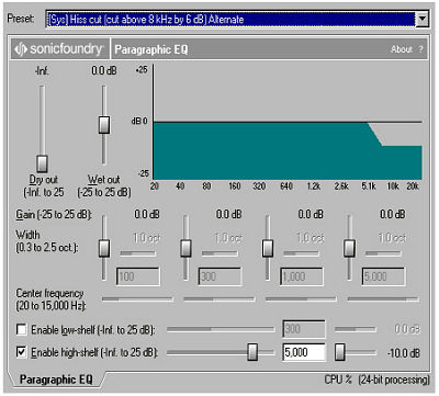

STEP 1 Hiss Cut

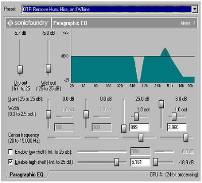

STEP 2 Hum & Whine Cut

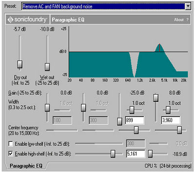

STEP 3 AC & Fan Removal

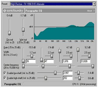

STEP 4 High Restore Compensation (Optional: May Cause Clipping)

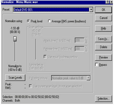

Step 5 Normalize Audio (Go to PROCESS --> NORMALIZE)

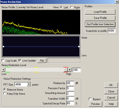

STEP 2 Noise Reduction Filter
The Noise Reduction function can dramatically reduce background and general broadband noise with a minimal reduction in signal quality. It can also remove tape hiss, microphone background noise, 60 cycle hum, or any noise that is constant throughout the duration of your waveform.
The amount of reduction required depends upon the type of background noise, and the allowable loss in the quality of the signal that is to be kept. In general, you should be able to attain increases in Signal to Noise ratios of 5dB to 20dB. (Noise is reduced 21dB and signal 1dB for example).
Before you can perform noise reduction, you must load or get a noise profile first. This is done by pressing the Load Profile or Get Profile from Selection buttons.
Here’s the most common way to use the Noise Reduction function:
1. Record or a piece of music that has tape hiss or other background noise.
2. Select a short range (at least one half second) that contains only the noise that you'd like to reduce.
3. Choose the Effects > Noise Reduction > Noise Reduction option and click on Get Profile from Selection to sample the noise.
4. Click on Close.
5. Select the entire file (or the portion you want to noise-reduce).
6. Go to Effects > Noise Reduction >Noise Reduction again.
7. Click on OK to perform the noise reduction.
Preview
Press the Preview button to audition the current Noise Reduction setting before you apply it to the waveform. The selection is looped until you press the Stop button. Since Previews are dynamic, this gives you the opportunity to make and hear processing adjustments as the selection is continuously played.

My only point was that some of those SOUNDFORGE settings you've got are more intended for special troubles on really bad audio tapes. Using them on otherwise good sound could really make matters worse rather than better. Using them for "general use" capturing VHS->DVD may be a bad idea.
The most common filters I use are these:
HISS CUT -or- HISS CUT ALT 2 -or- ALT 0
NORMALIZE 80%
then if still not fixed:
HIGH RESTORE (any) ... if needed
and HIGH RESTORE/HISS REMOVAL combo (any) ... if needed
Just remember to not correct audio too much. The less filters, the better off you'll be. Be careful. Even I'm guilty of doing more harm than good sometimes. Easy to get carried away. Can get real bad if the speakers on the computer react different than the ones on the tv/receiver.
All of these filters are essentially frequency carving. You're dumping the part of the signal that is bad. And then compensating the rest of it to make up for what was lost (or never present), essentially rebuilding the quality by shifting things around.
The guide on my site has these as presets download. Easier than making them one by one. I'm about to add another update in a week or so, got some new filters to add to the lot. Check it out sometimes later this month. Some of the new ones have REALLY been helpful too.Want my help? Ask here! (not via PM!)

One of my biggest hurdles in the VHS-to-DVD-R journey was cleaning up my hissy audio. I tried Audacity & Goldwave, which didn't seem to do the trick (for me). Then I tried Cool Edit Pro 2.0, and found the "hiss reduction" didn't work well either. However, "Noise Reduction" worked well after much experiments.
I use these tweaks:
NOISE REDUCTION LEVEL = 100
SNAPSHOTS IN PROFILE = 300
FFT SIZE = 8192
REDUCE BY = 40
PRECISION FACTOR = 9
SMOOTHING AMOUNT = 1
TRANSITION WIDTH = 0
I know everybody is different, but with me I can cut 99% of hiss with just about NIL degradation of audio. (Use the "help" button on the Noise Reduction dialog box, and read through each parameter).
