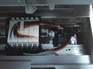

How To Install the Bulk Ink System on Epson RX500/RX510
Standard Kit
1. A set of 6 empty CIS cartridges (marked B/C/M/Y/Lc/Lm)
2. A set of 6 auto reset chips (attached on cartridges already)
3. A set of 6 ink stoppers (pre-assembled with tube already)
4. Syringe
5. Tube Holder x2
6. A set of 6 ink tanks (empty and clean)

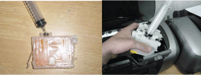

- Load inks from ink tanks to empty cartridges by using syringe
- When loading inks, hand ink cartridge up side down as picture shown in order to get rid of air inside the cartridges. Otherwise, banding may occur when printing
- Must load ink into cartridge about 98% full of cartridge. Stop loading ink when ink appear in the syringe

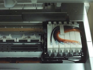

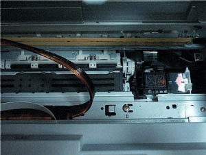

- Before installing CIS cartridges, please remove the print-head lid as picture shown.
- Stick tube holders provided in the box to fix tubes
- Adjust the length of tubes before turning on power
- Put ink bottles in the left side of printer
