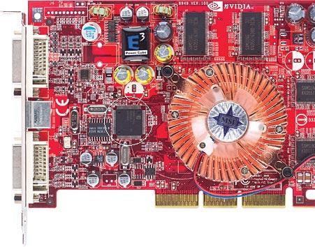

That's actually in reference to the TV -output- side of the card, not the tv input. i've been trying to find which capture chip MSI uses, but no luck so far. i take it this is your card? http://www.msicomputer.co.uk/Products.aspx?product_id=703434&cat_id=78 i can see a phillips chip on the card, but they don't say what one it is...... -
I am sure it has the same components but mine is here
http://www.msi.com.tw/program/products/vga/vga/pro_vga_detail.php?UID=561
It is not a TV card just has composite and svid inputs.
CheersAlan -
Interesting that the uk and tw pics for the same item are different!
What chip are you looking at as I'll check the card.
ThanksAlan -
Just checked mine is definitely the one on the tw site with the E3 Power Cube.
Alan -
Is the one i'm looking at. i think it's a philips chip, any chance you can stick down any numbers on it? -
ok, i googled SAA7115HL - that's your video encoder chip. Seems the chip is also used the hauppage WinTV PVR-350, so the best advice i can give for now is to look that card up here. really this topic also belongs in the capturing forum, not the digital TV one (as you're capturing in the analouge domain, not digital) hopefully someone there with the same encoder chip can help!
