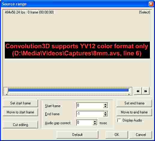

    I've installed AVSynth and loaded TMPGEnc. The ReadAVS shows in the TMPGEnc settings. hen I load the AVS file with all the correct paths I get a blank video. It doesn't appear to be reading the AVI data at all.
    Any ideas?
    LS

  15. Member LSchafroth's Avatar
    Dec 2002
    Originally Posted by FulciLives
    @LSchafroth
    Copy and paste your AviSynth AVS script here so I can see it please.
    - John "FulciLives" Coleman
    LoadPlugin("convolution3d.dll")
    avisource("D:\Media\Videos\Captures\8mm.avi")
    crop(8,4,-8,-4)
    SeparateFields()
    odd=SelectOdd.Convolution3D (0, 6, 10, 6, 8, 2.8, 0)
    evn=SelectEven.Convolution3D (0, 6, 10, 6, 8, 2.8, 0)
    Interleave(evn,odd)
    Weave()
    DoubleWeave.SelectOdd()
    AddBorders(8,4,8,4)
    ConvertToRGB(interlaced=true)

  23. Member LSchafroth's Avatar
    Dec 2002
    OK, I got TMPGEnc to load the AS file when I used the YV12 Convolution file.
    Here is my script:
    crop(8,4,-8,-4)
    SeparateFields()
    Interleave(evn,odd)
    Weave()
    I am using PicVideo capture and your advice says it should be top field first, but I have to do bottom first in order to get a good encode. If I choose top filed I get jerky video.
    I get teh following screen in TMPGEnc using this script.
    LS
  24. Member FulciLives's Avatar
    May 2003
    Pittsburgh, PA in the USA
    PICVideo MJPEG is a YUY2 codec although it might be possible to pick RGB but I don't think so I think PICVideo MJPEG is always YUY2 so you really should be using the YUY2 version of Convolution3D
    Try this script:
    ConvertToYUY2(interlaced=true)
    crop(0,4,-0,-4)
    SeparateFields()
    Interleave(evn,odd)
    Weave()
    AddBorders(0,4,0,4)
    That should (fingers crossed) work.
  25. Member LSchafroth's Avatar
    Dec 2002
    It works!!!! So I should capture using YuY2, use the correct Convolution3D and I should not need the convert to yuy2 command in the script correct?
