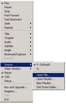

That's not how it works with WinDVD.
You have to choose "Play DVD from folder"
Then, your folder structure should be like this (c: is for example, mymovie would be the name of your ripped DVD):
c:\mymovie\VIDEO_TS
Then, point WinDVD to the mymovie folder without going into the VIDEO_TS folder and click ok.
It should then start playing it like a regular DVD.

The menu for WinDVD. Choose "Play DVD from folder":
