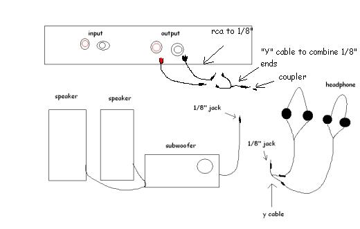

Wow, so then if I got this, I wouldn't need to get a switchbox? I could just leave my speakers plugged in all the time, and then when I use my headphones, I just switch them? Wait, then I'd run into the same problem before...
Well if you think the 8 analog out is a better deal, then I'll go ahead and order that one. As long as it does what I need it to. Does this soundcard do everything the Audiophile 2496 does?
I just actually thought of something, instead of getting a switchbox... I could have the following setup:
1) From the 2 soundcard outputs (2 RCA) to 2 1/8" ends, and then putting a "Y" cable (2x 1/8" to 1x 1/8") to connect it to my subwoofer (it has a 1/8" input).
2) Then when I need to use the headphones, I just unplug the 1/8" end from the subwoofer, and use a coupler, and another "Y" cable to connect the 2 headphones.
What do you think, hopefully I didn't lose you? -
Any suggestions? I was curious to know because I was going to go ahead and get the cables at RadioShack if they'd work.
One way to deal with your issue is to try to keep it RCA all the way and then use RCA to mini jack adapter at the end. I have couple of those and that seems to be most convenient way of addressing the mini jack "issue".
Looks just like the above but at the other side has a mini jack plug.
or like that:
Any of these would work. I like Proxy's ideas; they seem simplest.
As for the new card, I dunno. It was just released & I've never seen one. The outs MAY be able to be configured any way you want, so they can ALL be set up as L&R pairs to your various devices. That would rock for you, but I dunno for sure. -
