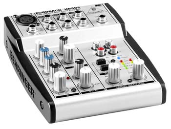

Thanks for the link. That is basically like the 502 but with an extra port? Sounds good... I'll check into that.
Plus the 502 only has 1 XLR..
But sounds like it might be enough for what you want to do.
I don't think there is much price difference between the 2 models though.
Ok, it seems as thought the 802 is a better deal then? Thanks for the advice!
