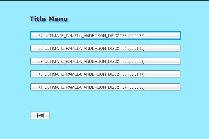

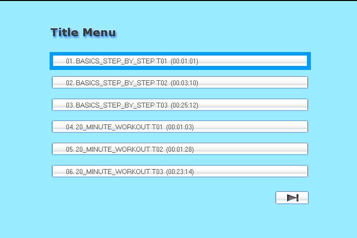

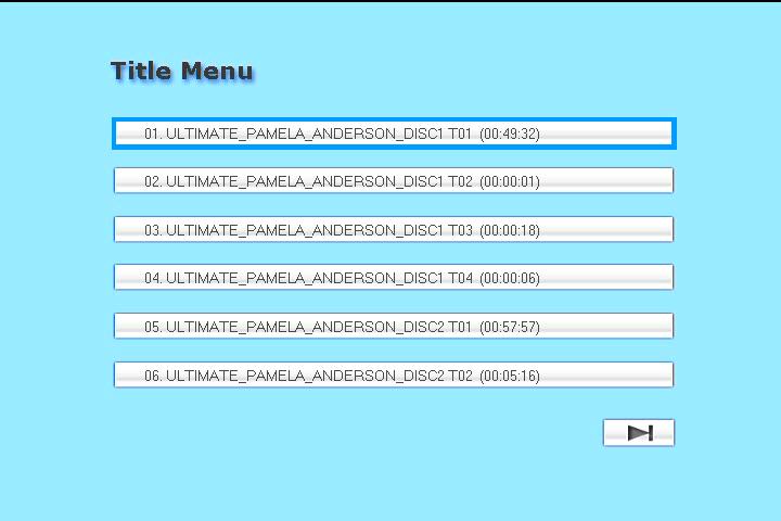

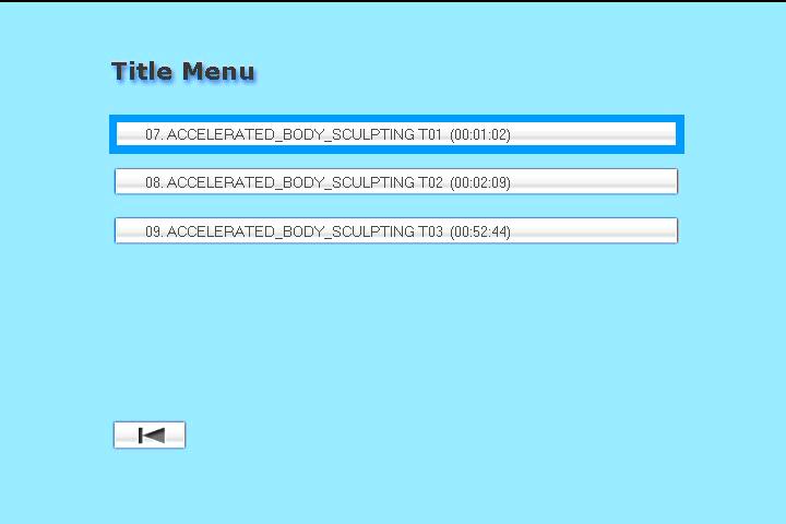

Yes you can, (well almost) and I have done this with the New InterVideo DVDcopy.
Granted the main menu of everything together can be confusing.
And you cannot adjust any of it to your liking but it does work maybe not exactly what you are looking for, but maybe the next best alternative.
I did this for the Winsor Pilates 3 disc set to 1 disc.
And I did this for the Pamela Anderson Disc 1 and Disc 2 Bonus Disc, Collectors Edition to 1 disc.
So it's possible (well almost) and given the alternative, editing all the movies and shorts(extra's) with DVDMaestro or DVDlab and making your own menu which is time consuming, etc... this is a great alternative, fast and efficient.
Oh ya almost forgot, even shrinks your movies and extra's down for you so you don't have to go through shrinking them and then putting them together.
There is a free 15 day trial with the InterVideo DVDcopy download. This maybe what you are looking for. Have not found any other program that makes the Main menu title set for all the the individual movies and shorts (extra's) except for InterVideo DVDcopy.
Word to the wise though once you install it don't uninstall it. In previous experiences I have had InterVideo products they have toasted my system when I unistalled them, not even a system restore was able to help. So just let them be.
Dragonfly2337 -

Trying to help someone out at 3:00am.
Correct, you cannot make One Menu that will take you to two different disc's and there individual menu's on one disc.
But the next best thing would be to use InterVideo DVDcopy that will shink both movies and extra's and make one menu with one or more pages to get to all the movies and extra's that were on the two disc's.
Unless you want to take the time to shink everything movies and extra's and then use DVDMaestro or DVDlab and construct your own menu's.
Hopefully my screen shot's of the Title Menu's all put together on one page will give a better idea of what I am talking about.
To big will try examples:
I hope someone finds this helpful. -
