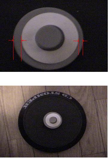

    Be advised, this is what he means by it working with all sizes (this is the fabulous CD Stomper and a Surething core label). I guess one size does not fit all.

  18. what does the stomper itself's background have to do with anything??? if the peg that goes into the disc is the same as the hole in the label, then it will be centered?? unless of course your label is some sort of weird shape!

    Please, try to follow along. The images show that Surething core label center hole is a little too big for the CD Stomper to properly center it each and every time. Therefore it doesn't fit the bill in this case, i.e., it won't center your core labels.
    Got it? Good. Remember we may be tested on this material.

  20. now i see where you're coming from. it's hard to tell about the MIDDLE of the label. and since you red lines were on the outside that's what i was looking at.
    "i see" said the blind man as he pi$$ed into the wind. "it's all coming back to me."
    so, from the sound of it...is there not a "stomper" type thing that's made specifically for this?? seems like that would be a simple fix.
  21. The fix is for Surething to make their damn holes smaller, like the Neato labels.
