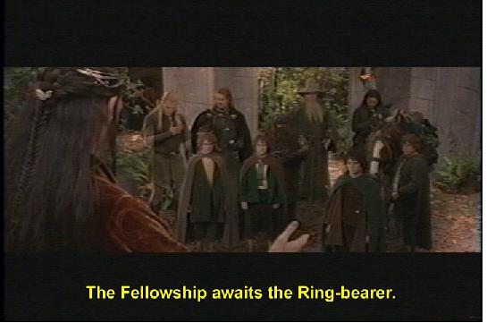

    Eg: I have an AVI file (Video.AVI) and a subtitle file for the Video (English.srt). The end result I want is an SVCD file with permanent subtitles. Preferably encoded as 4:3 but with borders (Movie 16:9) so that the subtitles appear in the borders (This makes sense I reckon, so the subtitles are not in the image).

    Virtual Dub with Subtext plug in installed (comes with Vobsub)
    Video in full processing mode, do your resizing first (I use Daniel Graft s Smart Resize filter for that). Audio in direct stream copy.
    Load the Subtext plugin, load the SRT file (play with the bottom margin - I put it at 10 instead of 20 pixels to prevent the subs from spilling over onto the movie area).
    Preview the video and you should have a nice AVI with borders and subs in the border.

    Not quite. You should already have your subtitle file. Load the video into Virtual Dub. Select Video-->Filters...-->Add-->TextSub. When the TextSub requester appears, load the subtitle file-->OK-->OK.
    Now when you play the movie, the subs will appear in the output window, usually the video on the right. If the subs look good to you, save under a different file name, using the codec you want.
