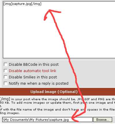

  7. I used the ulead video studio and pressed the capture button. if this is not what you ment by screen grabs please let me know and leave instructions
  8. Sorry new to this
    [img]https://www.videohelp.com/forum/images/guides/p943845/capture.jpg[img]https://www.videohelp.com/forum/images/guides/p943845/ Like i said i just hit the capture image button on ulead video studio and got this capture. which might not be what you ment for me to do if so please explain about the screen grabs

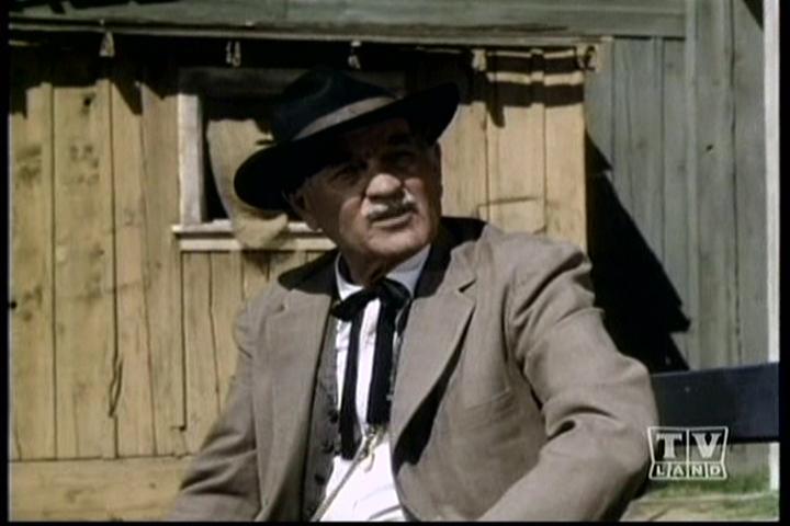

  10. First I would like to say im sorry for all the problems with my other posts.
    I clicked on the capture image button in ulead vs 7 se to get this image if i was supposed to obtain the image some other way please let me know

    So far the one picture you posted really doesn't look bad at all to my eyes.

    Again I see nothing inheritly bad about the one image you have posted.
    There really isn't much to do when you capture direct-to-mpeg with a hardware encoder.
    The card captures interlaced which is good. You don't want it to de-interlace.
    Outside of that there isn't really any tweaking you can do unless you re-encode the capture aferwards using a "video noise" filter of some sort but then again that sort of defeats the purpose of capturing MPEG to start with.
