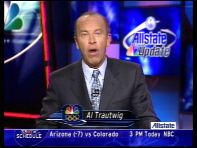

    Here is a pic from my DVD spec MPEG file:
    This screen cap done using WinDVD
  3. That seems to indicate that the source material is the problem does anyone have a different opinion?? Now let me ask can either the pvr 250 or an AIW card correct these problems on the fly??
    I dont want to spend anymore money and find that the captures havent gotten any better.

    By the way screenshot look a bit on blur side

    Stills are also useless. You can't judge from stills. Author to DVD-RW, play on a tv to judge quality. I cannot stress that enough.
    Yes my screen grab above does look a bit "blurry" but perhaps that is just the way it came out on the screen grab. It looks great (IMHO) playing it back on a TV using my Hollywood Plus card. I always encode through Avisynth to CCE and I used the AviSynth Convolution3D "video noise" filter ... perhaps my "setting" was "too high". I used the "movieLQ" setting. Maybe I shoud have used the "movieHQ" setting instead.
