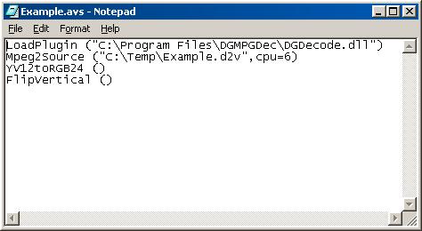

Copy this to notepad (except for "-------"), save as "template.avs", and place in the same directory as DGMPGDec
loadplugin ("C:\Ut\Video\DGMPGDec\DGDecode.dll")
mpeg2source ("",cpu=6)
YV12toRGB24 ()
FlipVertical ()
You must change the path of DGDecode.dll to correspond with your chosen location. You may or may not need the last two lines (YV12toRGB24 () / FlipVertical ()) depending on your destination format.

On a line preceeding "MPEG2Source("dvd2avi.d2v")" you should load the plugin "DGDecode.dll",
You have to load a plugin before you can make a request of its functions.
Your not trying to read the AVS file, your making the AVS file! Load the D2V file instead.Originally Posted by christaltips
It should be something like:
loadplugin("C:\DGMPGDec\DGDecode.dll")
mpeg2source("dvd2avi.d2v",cpu=6)
...but remember that my "DGDecode.dll" won't be in the same place on the hard drive as your will.
You don't open the AVS file with DGIndex (dgmpegdec). DGMPGDec reads the MPEG-2 and outputs a D2V, AviSynth reads the D2V through the use of DGDecode.dll. (that text file you made) VirtualDub / TMPGEnc / etc. reads the AVS-file (Example.avs)Originally Posted by christaltips

1. Use DGIndex.exe to read the MPEG-2 file, and a D2V file will be created.
2. AviSynth reads the D2V file throught the use of DGDecode.dll. Use notepad, (or the template.avs) to load the D2V file into AviSynth.
loadplugin("C:\"Your Location"\DGDecode.dll")
mpeg2source("C:\"Your Location"\"Your File".d2v",cpu=6)
YV12toRGB24()
FlipVertical()
(remember to put the path of your DGDecode.dll, and the path of your D2V file in place of "Your Location" / "Your File")
3. Open the AVS file with VirtualDub / VirtualDubMod / etc. The AVS file will appear as a AVI (uncompressed) to VirtualDub. (This takes care of Video-only)
4. Encode!
This is assuming that you have AviSynth 2.5x installed!
