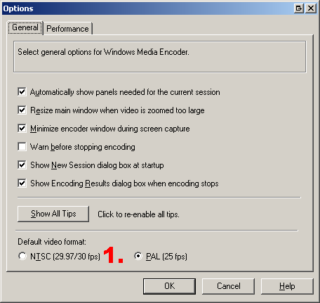

    1. Under Tools->Options change to NTSC if you live in a NTSC country(USA, Canada, Japan) and PAL if you live in a PAL country(basicly the rest of the world)

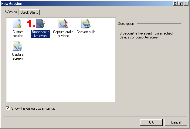

    1.Select Broadcast a live event

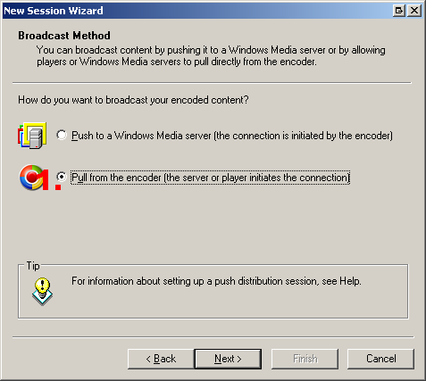

    Broadcast Method
    1. Select Pull from the encoder

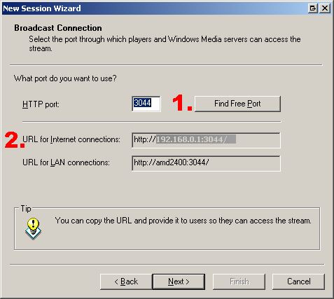

    Broadcast Connection
    1. Click on Find Free Port
    2. Copy the URL (this is your IP and you must be online when you do this)

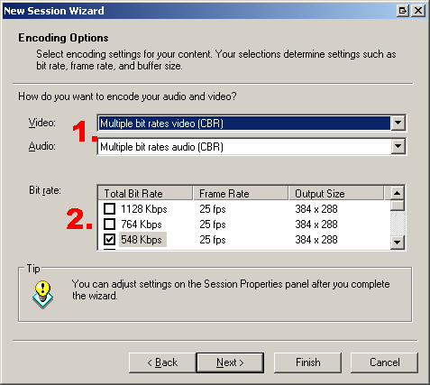

    Encoding options
    1. Under Video and audio you can select different video and audio quality templates, I usually use low quality like VHS templates.
    2. Choose the bitrate, higher bitrate means better quality but it requires faster internet.

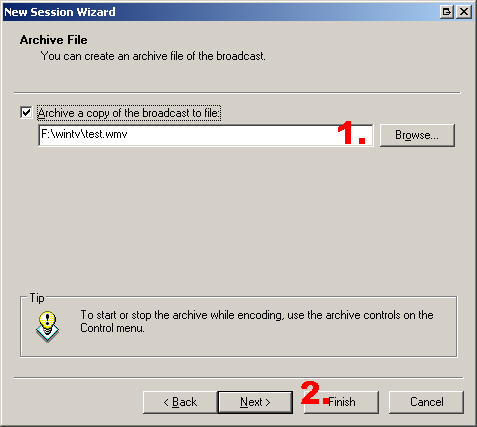

    Archive
    1. If you want to archive the capture specify a location
    2. Hit Finish

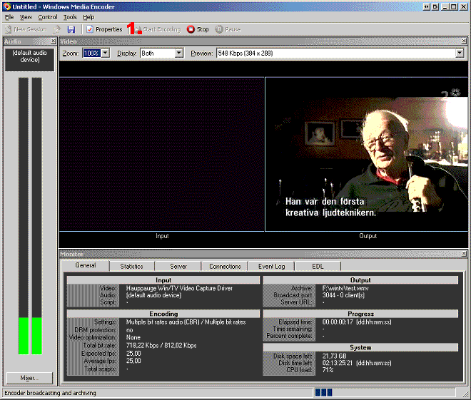

    Encoding and streaming
    1. Start the Encoding

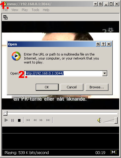

    View stream
    1. To view the stream just use the URL you copied above and paste it in Windows Media Player using File->Open URL. You can play it in some other Video Players also but it may require that you replace the http:// in the url with mms://, like mms://192.168.0.1:3044 .
