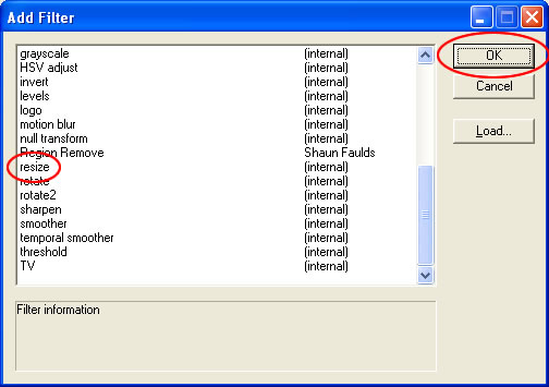

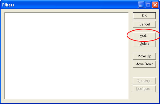

a) You must resize the video to DV AVI size. This can be done by going to VIDEO -> FILTERS. Then click ADD.
Scroll down until you get to RESIZE, then click OK.

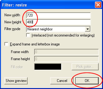

A Filter: resize box should pop up. In NEW WIDTH enter 720 and in NEW HEIGHT enter 480. Then click OK and then OK. On the right side screen the video should be resized to the new dimensions.
NOTE: Doing this may distort your video and make it very pixelated. If it is very noticeable then you may have to play around with other setting in VirtualDub to make the aspect ratio stay the same. As I said at the beginning of the guide: this is the easiest way that I have found to do things.

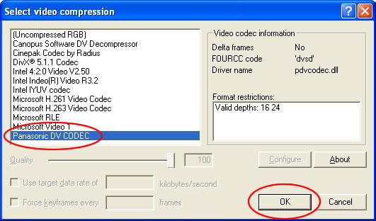

b) You must select the right compression for the video. Go to VIDEO -> COMPRESSION and select either the MainConcept or Panasonic codec (whichever one you installed on your system, you will see it on the list). Then click OK.

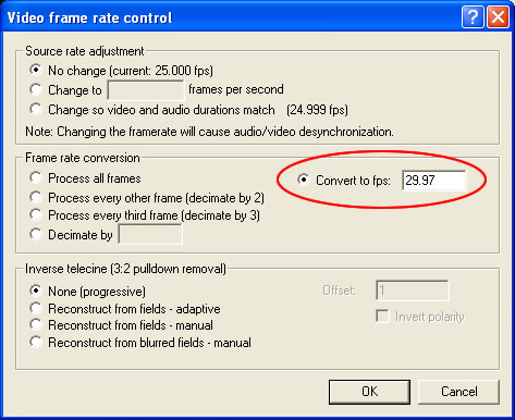

c) Now we will adjust the framerate to match what Premiere wants. Go to VIDEO -> FRAME RATE. Look on the right-hand side in the second box titled FRAME RATE CONVERSION. Look for "Convert to fps:". Click the check-circle and enter "29.97" (without the quotes) into the box. Then click OK.

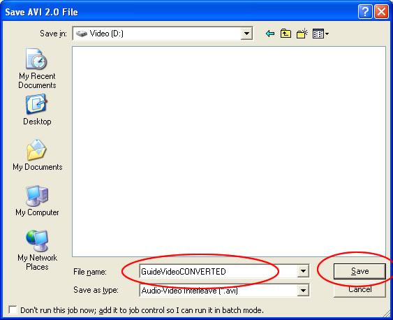

3) You're done changing all the settings! Now go to FILE -> Save as AVI... , and enter the location and filename of the finished video. Then click OK.

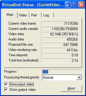

4) VirtualDub will now render the video to all the changed settings. This shouldn't take too long but you will have to wait for it to finish. It has the progress bar to show you how much time is left.
