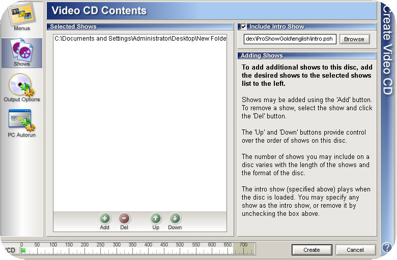

One way you could do it is to have two shows (e.g. show1 and show2) and have them combined into one show.
OK, great idea. How do you do that?
