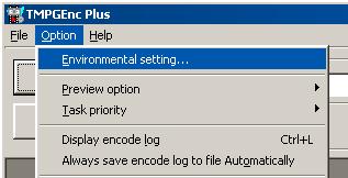

You could open the same file in TMPGEnc but without the AVI Readers.

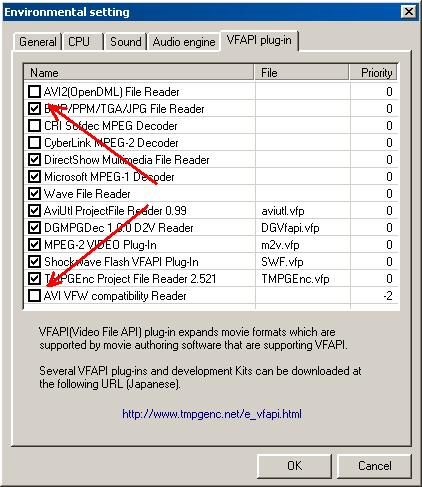

You can temporarily disable the plugins in "Option / Evironmental Settings / VFAPI" tab.
Then Uncheck the AVI readers.
Then load your file into TMPGEnc.
Your file should play through TMPGEnc the same way it plays through Windows Media Player. -
I'm saying that TMPGEnc can use a similar method to read the file as is used by Windows Media Player. (DirectShow)
TMPGEnc has an order by which it attempts to read a source file. The first choice in the list is AVI Reader. If you disable it, TMPGEnc will be forced to try another method, and will keep trying the different "Readers" till it finds one that will work. (see the one called DirectShow Multimedia Reader?)
What i'm suggesting is that if the source file will play correctly through DirectShow in Windows Media Player, then it might load through DirectShow in TMPGEnc.

OR Make sure the 'direct show multimedia file reader ' has a priority of 2 and moves to the top of the list.
